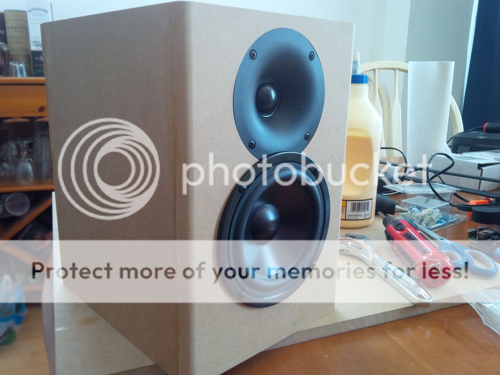

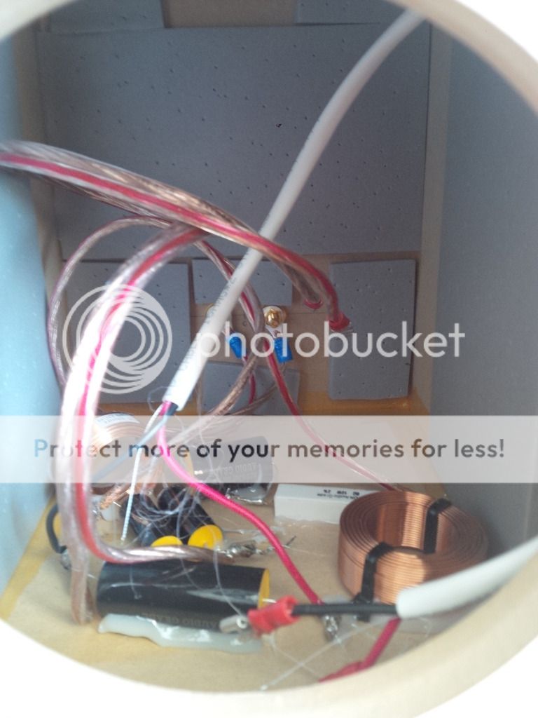

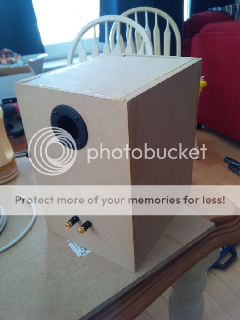

    Hey all,
    With the deal too good to be true on the C-notes kit from Parts-express, I figured they would be the perfect choice for rear surround speakers. Got package last week and worked on these over the week-end. As said in the C-note thread, I was pretty impressed with their performance. Here are some shots of my build. I also got some binding posts from parts-express for a clean finish, as well as some open-cell foam from my local electronics parts store, to add to inside cabinet walls;
    I will need to do the Veneering when it gets warm enough for me to work outside, at which time I will also do my Amiga towers and Sunflower center channel.
