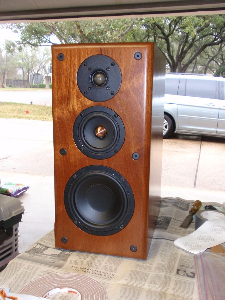

    Hi All,
    I finished these speakers earlier this year, but hadn't got around to posting them.
    I started the matching speaker stands and these speakers in 2015, but things got in the way...nothing new to any of you here.

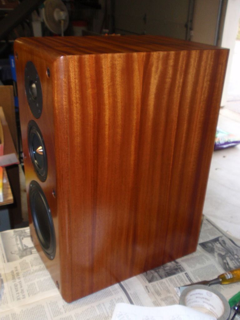

    I used some pre-veneered, ribbon-stripped mahogany MDF I bought from a guy on Craigslist a few years ago. Very nice stuff and I bought several sheets.
    I still have enough to build a matching stereo console to finish the whole vinyl setup, but that will be a project for later...
    I had some solid mahogany to use on the outside baffles. I confirmed that I do not like to use matching veneer and hardwood baffles, not enough contrast for my tastes.
    Especially in the bedroom I have these setup in, the lighting isn't bright enough to show the grain well.
    I bought this speaker kit 2nd hand (drivers and assembled XOs). There were issues with them from the start. The tweeter domes were smashed, but I was able to massage them out to almost smooth.
    I haven't heard any issues and don't have measuring tools to see if anything is wrong with them, so I am using them as is. The XOs were strange too, they used different types of wire and different gauges, like they were not made by the same person. They were also non-functional with broken solder connections and different caps in some spots, very strange.
    I ended up rebuilding them on new boards from the original XO design.
    I ended up making a mistake on the outer baffles when I was putting the 3/4" roundover on the edges. The board slipped under the bearing on one edge and I didn't notice until i had gone a ways...sigh.
    I was able top sand it smooth and fudge it over a little to "average" the uncovered box edge. Oh well, things happen in DIY.

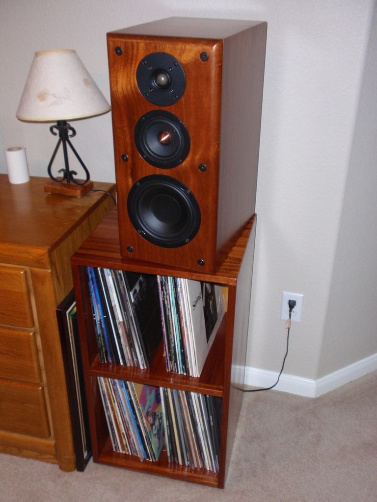

    Once they are in the room and playing, I really like them a lot. They have great bass for small-ish stand-mount speaker. With low content some-what limited on vinyl, they work very well in that room and the stands allow record storage as well. They are smooth and not harsh or bright to me (the way I like it). All in all, they are a great fit for that room. I use a re-capped Sansui 9090 and Thorens 145 M2 TT with them.

          Gotta love solid wood baffles! And that's a great space saving idea for the LP's, I;ve been looking for a way to integrate mine into my audio room.
