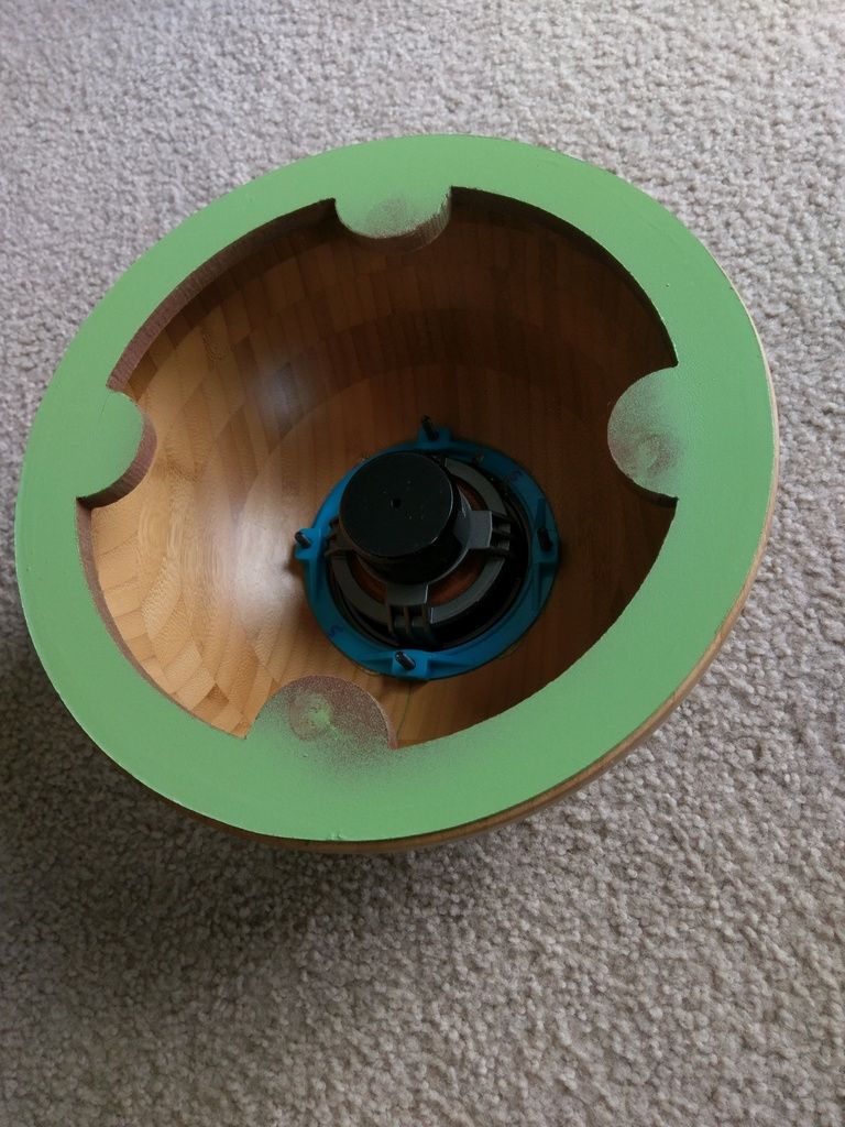

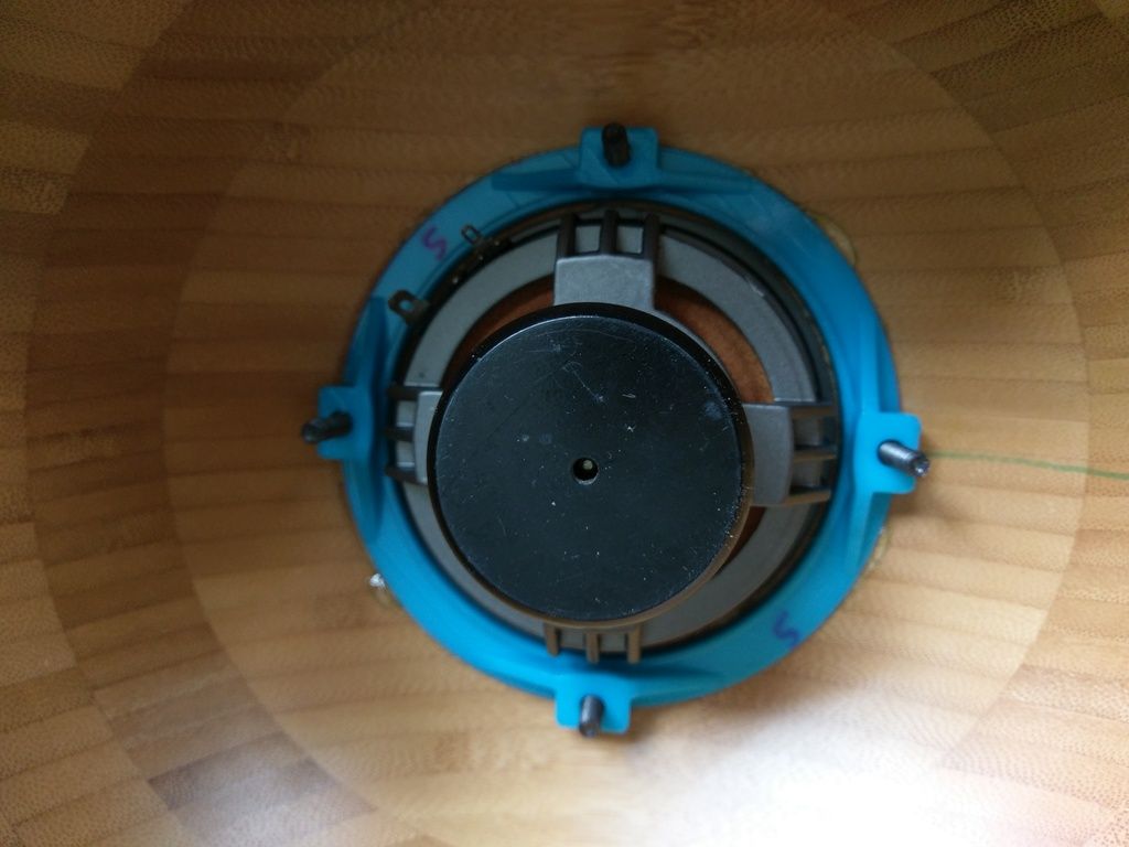

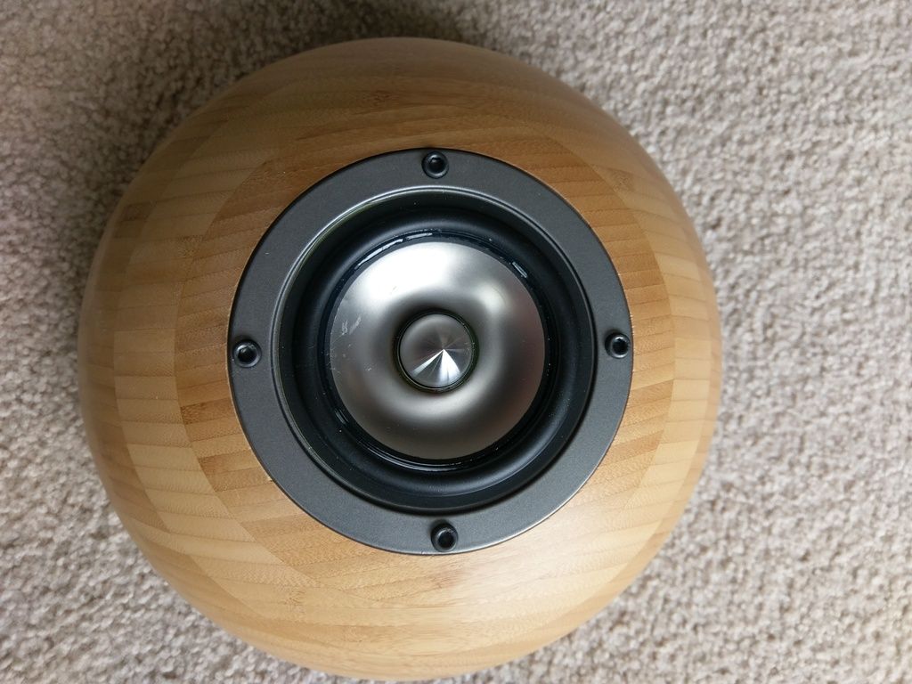

    Ikea wood bowls.

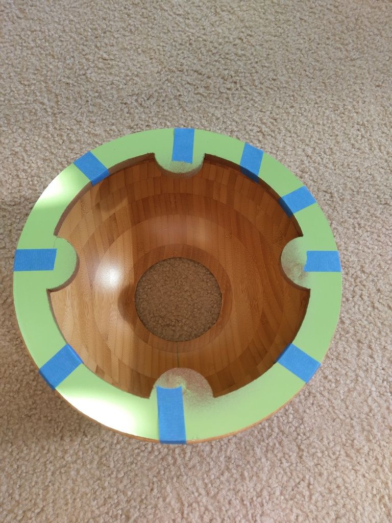

    Using the speaker and bolts to clamp the mounting ring in place. the edge gap is consistent (and prevents wood cracking). the Bamboo holes drilled are significantly larger than the bolt diameter
    Now these bowls vary in circumference a bit, but they are slightly flexible (and not fully round). Using tape, pull the sides in towards the mounting ring to achieve a more uniform bowl lip diameter and roundness. After drying this is VERY resistant to flexing
    Note that the MDF rings received 10 dips in Minwax wood hardener before having the outer lip and matting surfaces painted. The glue edge was sanded smooth (no paint)
