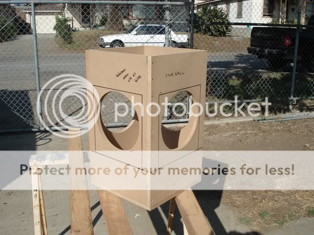

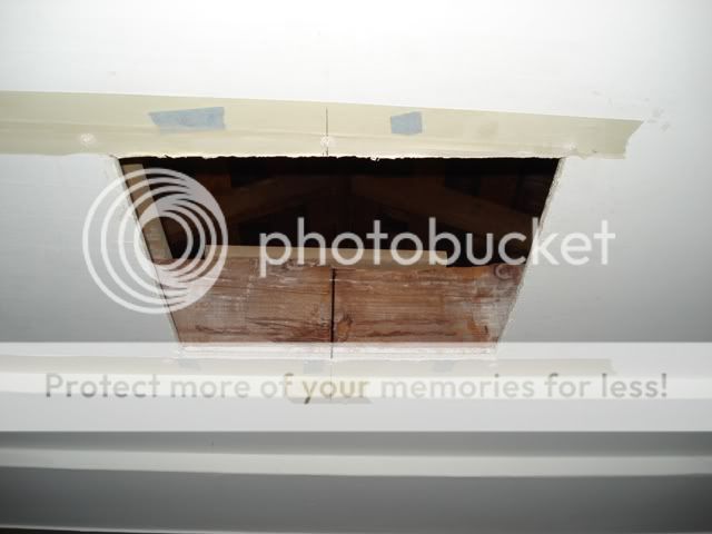

    the whole in the 70 plus year old ceiling

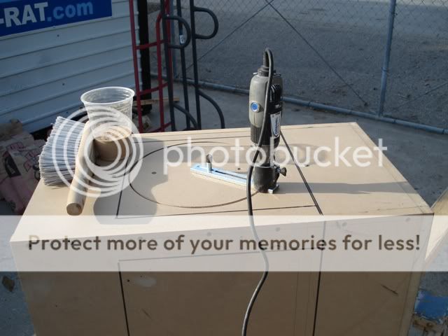

    my high quality dremel tool with an 1/8" end mill for cutting holes
    (not alot of box building pics, not really anything exciting about a plain mdf box)
    sub manifold with holes cut

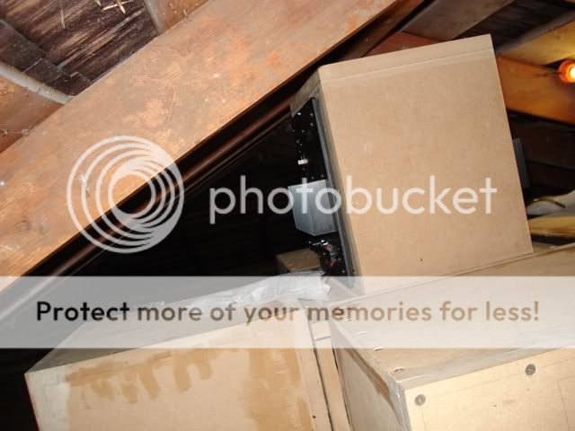

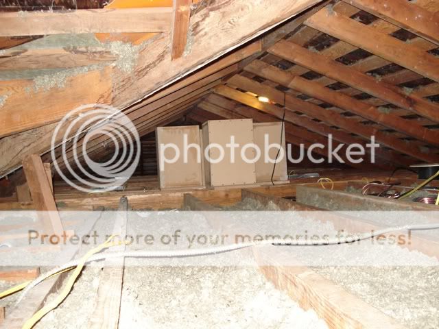

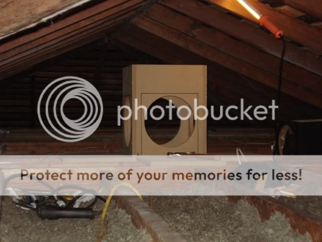

    sub manifold in attic
    4 - 1.5 cu. ft boxes in attic attached to manifold
    (im 6'4 225lbs, the attic gets really small in a hurry)

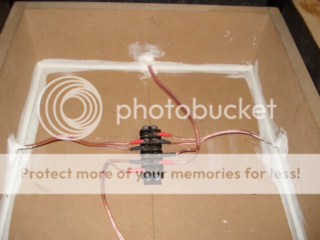

    sub wiring from boxes into top of manifold, subs are wired dvc in parrelell, opposing pair of subs wired in series to each amp

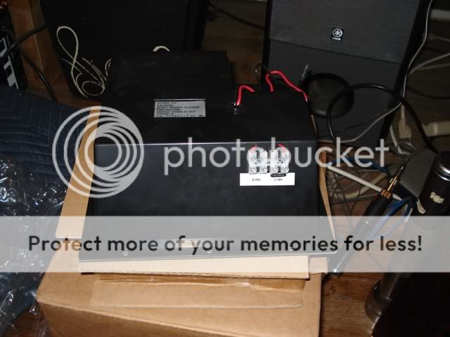

    the amp top hat box
    (my working space is shrinking very fast)

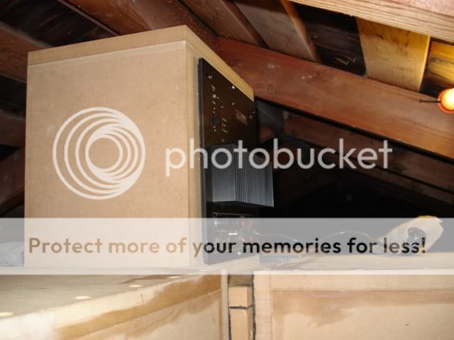

    the amp mods, for "easier" changes to the 2 resistors for changing boost level and frequency
    the 2 amps installed on the top of the manifold

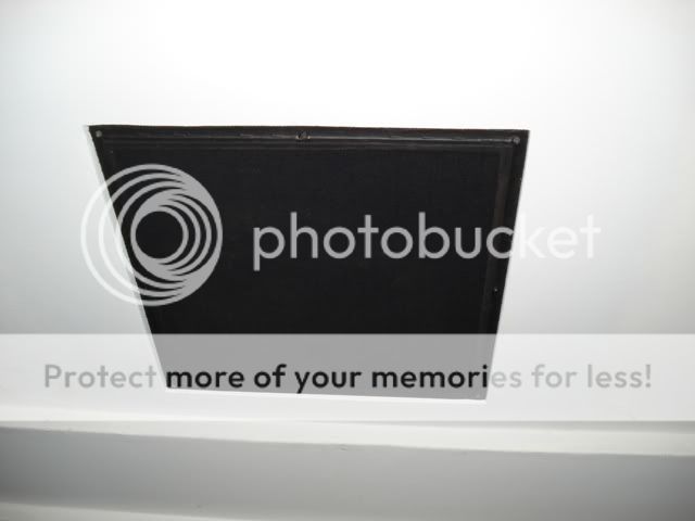

    simple grill distracts from large vertical hole in ceiling
    and now my ceiling goes boom! explosions on movies are good!!

      white grill was the plan, but i had a pair of older techincs speakers in the garage, and one of them was nice enough to donate its grill cloth to the project. i will not lie, i am cheap or as my dad always said "he wasn't cheap, just frugal. careful where his money went." i guess some of that rubbed off on me.
