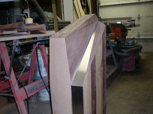

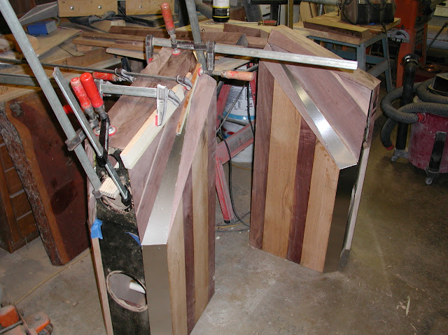

    Here are the tops cut and glued on.
    Tops with removable baffle in place. Next I will need to shape the tops to the sides and fine tune the front baffle to fit more evenly. then cut the driver holes.

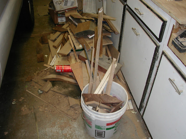

    Just so you don't get the false impression that I keep a super clean shop. This is mostly scrape from this speaker build and its going to get even uglier. I start a custom made cupola with windows for on top of a "witches hat" roof in my shop tomorrow.
