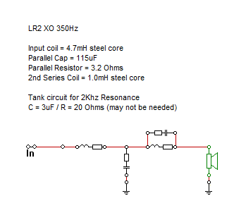

    LR2 at 350Hz (played with a bit)
    And the LR2 schematic:
    Basically, you can do a lot with these and they are likely good to near 1Khz, allowing use of a dome mid and a higher XO freq as well.
