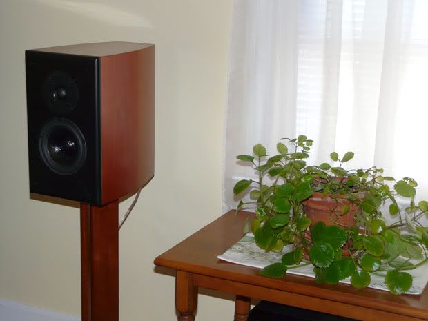

    In the meantime my wife saw the finished speakers and said "your keeping those aren't you?" :D So, they now reside in our living room where no speaker system has sat for many years since we first got married and I owned a HK compact stereo. Bass extension with these woofer mids in these vented cabs is surprisingly low and articulate. Reviews from fellow audio society members who've visited for extended listening sessions have been very positive.
    I decided to call these speakers the Intimates because they aren't designed for regular 95+ dB listening. They perform best with acoustic music and vocals from smaller groups. I have them on 26 inch high solid cherry stands located about 1 ft from the wall to take advantage of the vent's reflected output. Being a hugh fan of classical music, I also listen to symphonies with them as well. They hold their own, but obviously don't have the big, complimentary symphony sound you'd get from a much larger multi-driver speaker system.

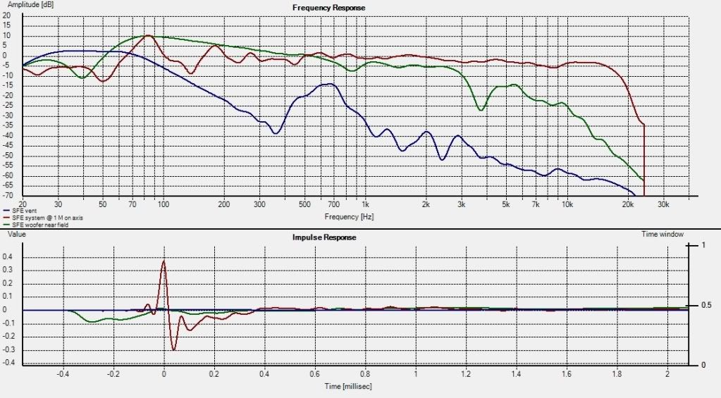

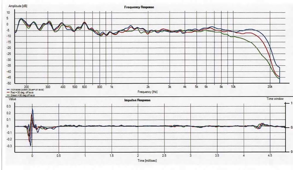

    Below are a couple of teaser pics of the speakers and some measurements which some of you may have seen posted in other threads. Visit here for more detail pics of the internals, BB dwg and xo schematics. http://s1219.photobucket.com/albums/...ct%20pictures/
