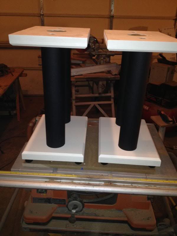

    Saturday was a decently warm day so Kanemack and I decided to get a little painting done. It went very easily and I really like the way it turned out (a lot more than I thought I would). The stands are pretty awesome and sturdy. I haven't even glued the top half together yet and it's holding like a champ. This is the silver rustoleum hammered paint in a 1 quart can with a roller. I'm surprised how even it layered itself and didn't make a bunch of streaks or anything. The stands are the same size as the base of the finalists double laminated 3/4 MDF glued, screwed and epoxied. It used a 3" ID thick wall PVC piping for support in the front and back. It's wrapped with Part's express vinyl black textured wrap. That wrap is pretty sweet. It has a minor smooth texture.
    If I can offer any suggestions if you paint this with a roller do it quickly and put it on thick because it will start to get very sticky and can pull off the material on the roller or change the texture......luckily we actually used a TEST PIECE and figured this out before hand! This is my first painted speaker, I have wrapped the Tarkus/armadillo and they look pretty dang good! I need to try a gloss paint job and try my hand in some veneering next.
    Anyway here come the pic's! Still need to paint the stands. I'm ok with them just primed but the wife likes red and she was on board with me putting these our living room so I'm gonna make her happy and paint them red!

    Wow, great results! Love the stands and how nice to have your spouse get to choose the color. I know some women that wouldn't "allow" speakers like that in the room. I'm sure your impressions on the SQ are equally great. I might have went with the Finalist if they had been out when I started on the Statement Monitor build with bungalow_ed.

            Nice! I'm going to go with Black Hammered for the Digger 8, possibly by this weekend. I'm using small foam rollers, as I used a brush with Silver Hammeed on my Hitmakers and the finish was not so good. It was also cold when I applied it. I'll take any and all advice you can offer with that paint.

              Thanks, they are kinda big, I prolly should have went with floorstanding speakers lol, with the stands they are pretty huge!
              I think I would try an foam roller vs the nap (spelling?) due to the stickiness of the paint. We used this primer/bin/shellac http://www.homedepot.com/p/Zinsser-1...0904/100398380 . It covered well and dried fast. We did all our bondo and sanding before priming so I barely touched the primer. When your free let me know we live close enough to have a listen just bring something you want to listen too. I don't have much for music upstairs.
              The biggest tip I can give for the paint is to work the paint into roller initially very well. Then work quickly to get the cab painted and once the cab is painted fix the runs on all 90 degree corners (basically the roller squeezes out when you go over the corner and leaves some extra). If you get the cab painted very quickly enough it will not become sticky and you can take care of the runs. If it becomes sticky and you see little strings (like a hot glue gun when pulling away) then just stop your going to make it worse! So if you notice any imperfections after they are sitting just resist any temptation to go for another roll to "fix" the problem it will only make it worse. Wait until it dry's a few days and then touch it up, or sand and repaint that side, or if it's small you can use your finger to smash it down while it's soft (it takes 2-3 days to become hard).
