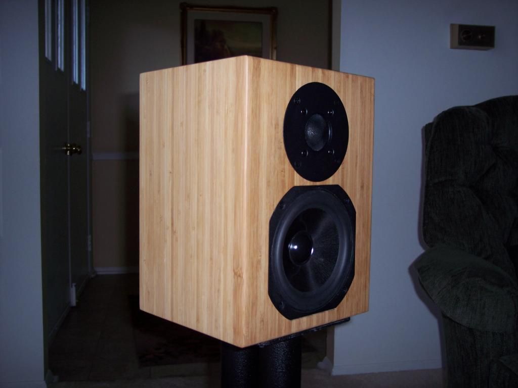

    The popularity of the little Continuums has been fun. So, I thought that maybe I could improve the experience for some potential owners. I took my idea to Erich at diysoundgroup, because when it comes to getting things like this done Erich is totally awesome.
    Well, he liked my idea and after tossing back and forth different ideas we settled on the following. A professionally made CNC cut cabinet made of solid Bamboo. Bamboo is a very hard, strong, and dense wood and it turns out it machines beautifully with a very smooth surface. Since the cabinet will be fully assembled from the manufacturer we went with a conventional front flush mounting of the drivers. The recesses are CNC cut and fit the drivers perfectly. It is a very professional looking speaker.
    Erich has sent me a pair of the prototypes and in order to adequately test everything I ordered a full Continuum kit from Meniscus. I figured it was the easiest way to get all that I needed, and even a few extra parts to put back. The kit has everything a person needs except the cabinet (wire, screws, gasket material, binding posts, egg-crate foam, etc. all included)
    This was the first time I have seen the way the kit comes and I was surprised at the way Meniscus did the crossovers for the kit. I found it very interesting. It comes with pre-cut boards that fit through the woofer opening with no problem. These come with a peel-away decal that you peel off and stick to the board. The decal shows where every part for the crossover needs to be placed and instructions show how to wire it. It’s a nice little feature for the guy putting the crossover together.
    The next surprise I got from the kit was how it turned out. I made my original set of Continuums in 2006. They were introduced in 2007 at Richamond IN gathering and by 2008 I was authorizing other people to make them. There are a lot of them out there now. However, this is 2014 and things can change a lot in 8 years. I was concerned that the drivers, since they are Chinese made, may be different now. I know the cone of the woofer looks a little different than my cones look. So I built a set the bamboo cabinet with the new drivers to compare with my original set. I was also concerned about the different offset with the woofer.
    First, I found that the difference in offset makes almost no measurable difference at all in the summed response, probably due to the low crossover point. Second, I found that the new drivers do measure slightly differently than my original set. The new “bamboo” Continuum has slightly smoother frequency response, which was a real surprise. So response differences worked out to make the speaker a bit more linear. I have been listening an tweaking and have decided to leave the crossover unchanged from the kit. This give the best overall balance and sounds like, well, a Continuum. And finally, what the new woofer gave up in a little sensitivity it gave back in bass extension, as the new speaker extends about 10 Hz lower on the bottom end (flat to 60 Hz and good bass to 50 Hz and below).
    All in all I am very pleased with the sound from the bamboo Continuum. In fact, I still think this is the most balanced sounding mini-monitor I have ever heard, and it may be a little better now. The BBC acoustic scaling of this speaker is right on the nose and midrange and high end distortion are very, very low. vocals have such a natural balance that on some material it's uncanny.
    We're still working on details and I have no idea about pricing, but I really enjoy this little speaker. This cabinet, and the fact that I can now officially endorse front mounting of the woofer, will make it a lot easier on builders. Erich has an idea for a solid Corian cabinet too, which will have mass that will probably easily exceed my original maple cabinets (the bamboo are lighter than my maple ones). This could be an nice upgrade, even over the bamboo. I am looking forward to checking that out too.
    Here are a few pics of the bamboo cabinets.

    Those look absolutely fantastic. Glad it all worked out!

      They are beautiful cabinets. I have heard so many good things about the sound I am sure they are fantastic.

        Wow, those are some nice looking cabinets!!! I actually like the woofer front mounted, but I'm sure others will totally disagree.
        +1...Bamboo Cabinets from Erich, I think I would have to invest in a pair of those.

          Beautiful Jeff, just beautiful... a classy little speaker and I hope to get a chance to hear them someday. I have been intrigued by your continuum design for a few years now. I am a big fan of the Harbeth lineup and history and house sound of that speaker line, and I have always thought your Continuum was a real contender with the P3esr and if I am not mistaken you have hinted at some real confidence in your design given any opportunity to go head to head. I would not be surprised at all if you have managed to humble that commercial product with this design.

                    now that is what a speaker is suppose to look like. great job on the cabs.

                      Awesome cabs. I prefer the front mount as well.

                        I dig it. I suppose the bamboo can be finished with some sort of oil, such as Danish oil or Tru-Oil? I think that would make the grain stand out and would look fabulous.
