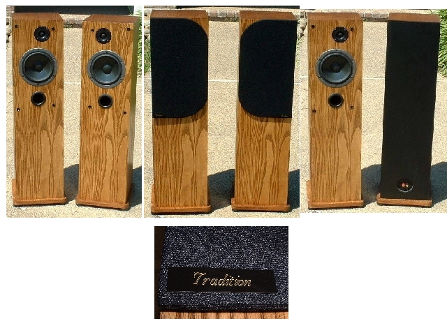

    These were built with a combination of 3/4" and 5/8" particle board. I braced well and had no problems. But they were budget speakers that I wanted to look good, so the greatest amount of money in them is the veneer. I applied the veneer with the yellow-glue iron on method and had no problem. They were a gift and I have not heard any complaints from the recipients, nor did I notice any particular resonances when I was listening to them.
    Having said that, I would not use PB for the D8TMs. I would not hesitate to use 3/4" PB for the DBs. BTW, I used PB because I had it around from other uses, and because I picked up some sheets for a buck apiece at HD from the cut out rack, intending to use them for grills and internal braces.
    HTH
