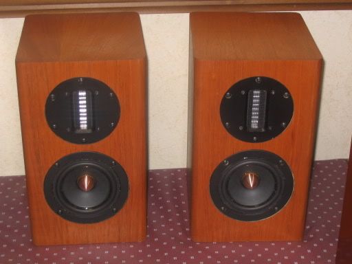

    Clearly, as others have stated, we had a great time this weekend at the Dayton DIY event. Meeting the names behind the posting names was a pleasure. It was fun to hang around fellow speaker nuts for a couple of days. Perhaps next year we'll have another parking lot faceoff of car audio systems plus an extreme SPL contest.
    Several of you had favorable comments on the sound of the my new line arrays. My wish it that you realize the benefits of room corrections. Eventhough you can calibrate a speaker to have perfectly a flat frequency reponse, once you place them in a room their sound changes. A few minutes to EQ the room modes, insert a slight BBC dip, and correct several higher frequency peaks converted a bright sounding speaker to a great sounding one.
    Several of you asked about the ML-TL bipolar speakers that I brought along. A parts kit for these speakers can be obtained via Creative Sound Solutions at:
    <A HREF="http://www.creativesound.ca/details....del=FRWRBIPOLE">http://www.creativesound.ca/details....del=FRWRBIPOLE</A>
    The parts kit costs $260. The plans are accessed via the Cabinet Designs link at the above site or you can go directly to:
    <A HREF="http://www.planet10-hifi.com/boxes.html">http://www.planet10-hifi.com/boxes.html</A>
    Next click on the picture of my speakers for a .pdf file which contains the enclosure drawings. I accidently left off the port tube from the list of parts in the .pdf but it is a P-E #260-404 cut to 3" length. That part should be in the kit though. Let me hear how you like it.
    Finally, I appreciate the help that Shawn and Paul gave me Friday afternoon for both room set-up and in dialing in the room corrections.
    We'll do it again next year!
    Jim
