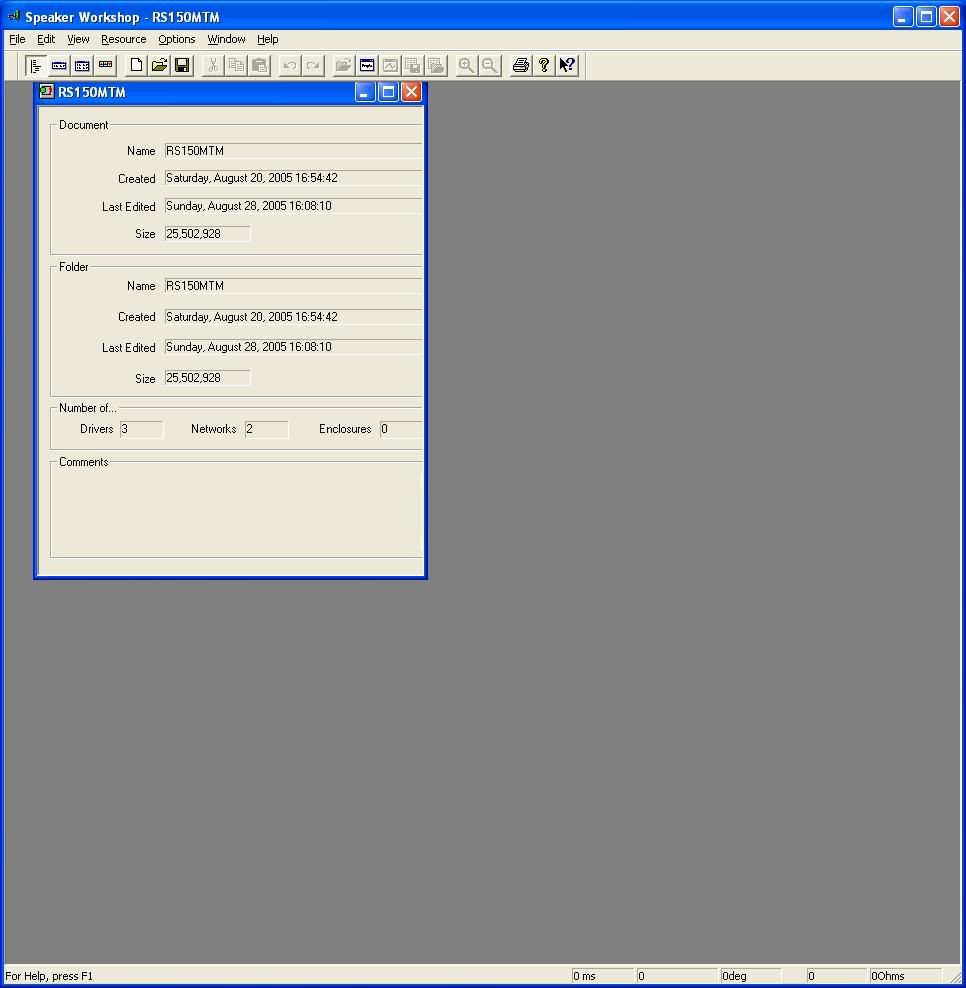

    I opened up Speaker Workshop just now, and the left-side file browser bar is non-existent. I've clicked that little button in the top right corner that should toggle it on and off, but it's still gone. I think the problem is that, last time I was working in SW, I resized the bar all the way down (You can usually resize it all you want - there's a little bar on the left side of the screen, but that's gone now) and left it that way when I closed it.
    Any ideas on how to get it back? I've reinstalled, but I guess some registries didn't get deleted.
    Check it out...

    Make sure that Project Tree is marked in the View menu.
    If it is...
    Close Speaker Workshop
    Open the registry edit by going to the Start menu and clicking on Run. Type regedit and click OK.
    In regedit's tree pane on the left, click the plus signs on the following path to get where we need to go:
    HKEY_CURRENT_USER
    Software
    Audua
    Speaker Workshop
    Structures
    In the detail pane on the right, highlight TreeInfo and press the delete button on your keyboard.
    Restart Speaker Workshop. The Project Tree pane should be back.

    Thanks! It's back!
