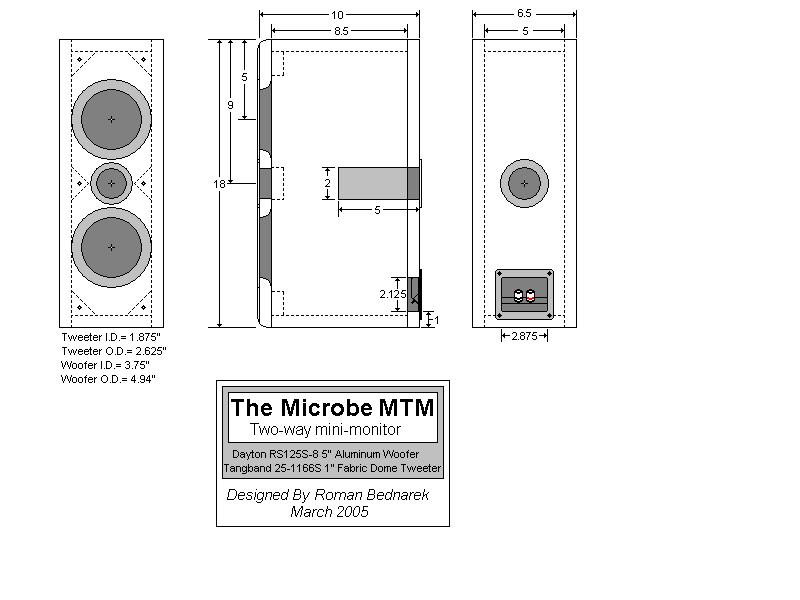

    If money is really becoming more of an object, I have an inexpensive 2-way design that might work for you using the RS-150 with the Seas 27 TBFCG. It placed second in a virtual dead-heat with cjd's winning RS150 MTM at Chicago Audiofest - but is less expensive (drivers and crossover for less than $100 per speaker) and has an impedance that would work with your existing receiver. I used the 0.25 cu. ft. P.E. box - if you want to run them without a sub, then something closer to 0.35-0.4 cu. ft. would be better (keeping the baffle width about the same).

    Default Re: Triune or Modula MT *PIC*
    Provided Link: RJB Audio Projects

    Sorry about the late response but I thought that I'd give you another option if you are interested. I designed a speaker that uses dual RS125 drivers along with the Tang Band T25-1166S tweeter in a 2.5 way crossover format. Since it is a 2.5 way design it can be used as a center channel fairly well. It can be used for all channels as a matter of fact for a perfectly matched surround sound system. I think this is important because you will get superior imaging with matched speakers and the tonal balance will also be perfectly matched. Below is a picture of the cabinet design and I have the crossover design somewhere on my computer... I can dig it up if you want. The only issue is that the impedance of this design dips down to 4 ohms in spots so it requires a fairly decent amp to drive them (especially 7 if you plan to do a full compliment).
    These speakers are a variation of my Microbe design which has gotten a lot of praise from a lot of people so I think you would be more than happy with the sound even though I haven't actually built this exact speaker. Let me know if you are interested and I can give you more details about the crossover. By the way, somebody else is building a different version that is slightly less sensitive but has an impedance that is closer to 6 ohms using impedance compensation and woofer resistors (it's not something you would normally do but it seems to work well in this case).
