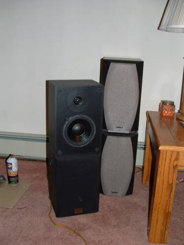

    Not sure on the cabinet size, but I did a Sony retrofit (speakers on left) using the BR-1 design. See if your volume is close to the PE BR-1 kit, and if so consider buying the drivers and components to build it (minus cabinets). I would also recommend checking out Dennis Murphy's crossover designs, in liu of the BR-1 crossover. I believe the 6.5" driver is currently on sale at PE, and the total should be close to your budget. I believe there are many other designs out there that will work with that size cabinet, so look around and read a many comments as possible.
    As far as the Sony cabinet, I believe mine were 5/8" fine particle board. I reglued all the joints, and added two broomstick braces. One front to back, and the other side to side. The port was put on the side, and cabinet walls lined with eggcrate accoustic foam.
    JohnS
