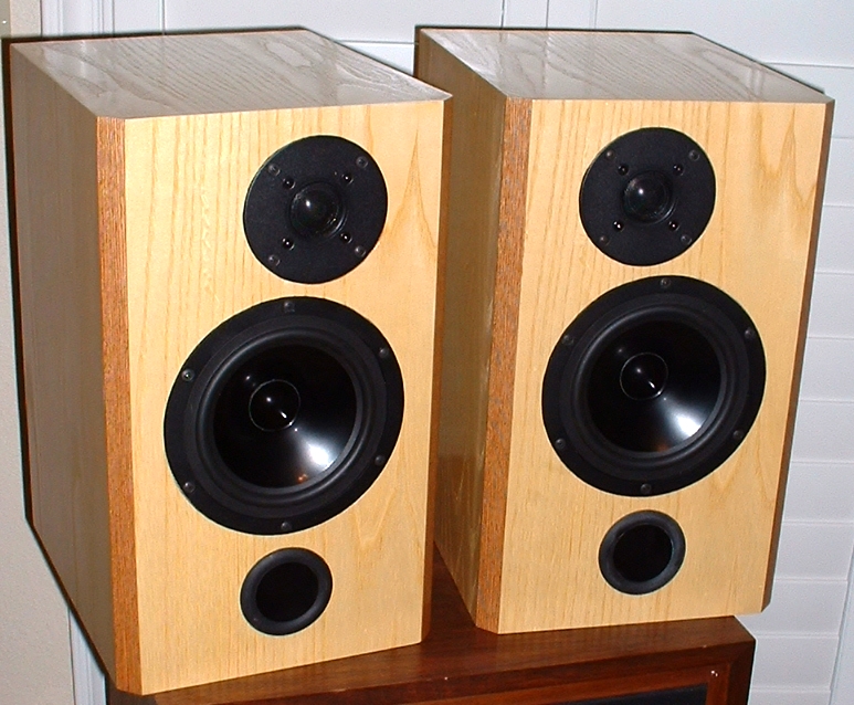

    Default Re: how do you veneer? *PIC*
    Provided Link: Advocate
    I use the wood glue iron on method, using TiteBond II, and have never had any problem. Go to this url:
    <A HREF="http://www.oakwoodveneer.com/tips/ironon.html">http://www.oakwoodveneer.com/tips/ironon.html</A>
    I use 10 mil paperbacked veneer. I have never tried contact cement, but have avoided it due to the volatility, smell, and lack of forgiveness -- once it contacts, it is set.
    The project below and the linked pics are both of projects I did using that method:
