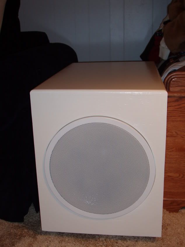

    I use two in 3.3 cubic feet each, sealed, 65% stuffed.
    I just demoed them in my buddy's suburban... and BROKE a window.
    cha-ching!
    NK

    Default Great for HT. *PIC*

    My buddy built one using 5.5 cubic feet and a 4" diameter, 17" long port. FANTASTIC!!

    That is approximately what I have. I used a four inch full length Precision Port (flared on both ends). I LOVE IT!!
