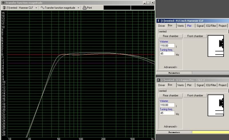

    Just got these yesterday. They were double boxed and both boxes were foamed. The 15 inch 'Hammers'
    <A HREF="http://www.partsexpress.com/pe/pshow...TOKEN=48950367">http://www.partsexpress.com/pe/pshow...TOKEN=48950367</A>
    A great job by PE shipping...
    They match pretty well against the Kappa 15;
    <A HREF="http://www.partsexpress.com/pe/pshow...20&ctab=2#Tabs">http://www.partsexpress.com/pe/pshow...20&ctab=2#Tabs</A>
    Even the ports;
    <A HREF="http://img.photobucket.com/albums/v6...r-15-Ports.jpg">http://img.photobucket.com/albums/v6...r-15-Ports.jpg</A>
    Project #6 is starting to shape up. Probably be a summer project.

    Looking nice and those Hammers look like they will do the job quite nicely. I've just changed the port tuning on my facets to the picture and am listening right now. Haven't really heard much of a difference but sometimes it takes a lot of songs to hear it. The ports are now dual 5.5" instead of dual 15". Here are the predicted box responses for this tuning:
    F3=43
    F6=38
    F10=34
    30hz Low Cut on Amp

    Of course you'll let us know if it's boomy.
    Pic below is with 2 - 4" x 5.5 inch tubes...

    I listened to the entire CD Pete gave me and it was good to go. Gonna listen to some DVDs tonight. Not boomy at all. These woofers, including the Hammer since they are made by Eminence, have a small x-max but very tight clean sound. THe kind I love. Make sure you have a low-cut rumble filter in place just so it doesn't unload and possible damage something. They're to expensive for that

    I can see why I'll need that filter!

    Dude- try modelling it at about 25W, that is more accurate of where you'll drive them. I RARELY push my 95dB speaks with more than a couple of watts. Xmax isn't really an issue in the home environment. According to the Bob Cordell amp tests, a 95dB speaker will only require 17W to not clip at a moderate listening level. You have to consider that 4-5W is all you'll need to breach 100dB, and that is VERY loud.

    OK, I've listened to about 6 diffenent CDs and DVDs and all is good to go. Definitely not boomy but the lower bass is a bit more defined. I like my bass and I think most of us do. Try this alignment, I like it better than the slow rolloff. More kick on the bottom end and not the HT boomy stuff. I was afraid it would be too much bass but it's not to me. My final step is to get these beasts outside and actually measure the final response on and off axis. Being 120lbs and many other things to do on the todo list may make that in the future some time. BTW, play it safe and use your subsonic filter on them. Most amps have one.

    But you've added a highpass filter too. How does the whole transfer function look with the higher tuning and the filter together?

    I saw it up on the post above that sucked up all the bandwidth.
    You definitely will notice more bass in the 40Hz region, and less below that.
