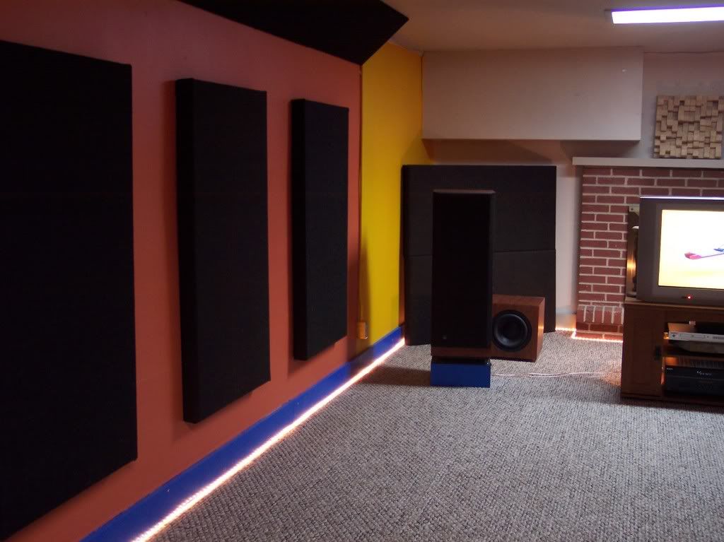

    Default Nate is right *PIC*
    Catching those first reflection points is key to releasing the detail in your source material. The best upgrade you can get your system is some room treatments! You will be amazed at the difference in sound detail and they dont even have a plug. And yes, they are way easier to build than your average set of speaks. My whole room has 8 mid/hi absorbers on the side walls, bass traps in the corners and where the wall meet the ceiling.
    All done for under $500.
    I got plenty of info and some pics of construction if you decide to make a worth while jump.

    Default Look good
    Cole,
    Very well done! You're room treatments look great! Actually, one of the few *budget* treatments that I've seen with some real aesthetic appeal (of course those systems that the pro-jocks and hollywood celebs install always look great, but that ain't DIY!).
    I'm interested in seeing some pics as I'm in the throes of finishing a basement and installing a HT.
    Thanks,
    TTS

    Default Re: Nate is right
    Nice job Cole! And it blends in with the walls making it look like it's part of the room. I like your colour combination too. Excellent job and I will try and keep this in mind for my next listening room.
