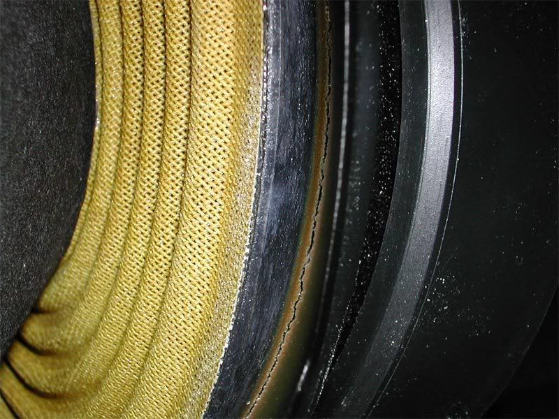

  14. #14
    Join Date
    Nov 2005
    Location
    Silver Spring, MD
    Posts
    1,606
    Default Spider Detached- *PIC*
    This is a pic of my first Quatro 15 which I sent back to PE. If I compressed the joint with my hands it sounded so much better, so it would be possible to fix but in my case it was brand new so they took it back and replaced it with a new one that has been fine ever since (Over a year now).
  15. #15

  16. #16
    Join Date
    Oct 2005
    Location
    Oregon
    Posts
    335
    Default Re: Spider Detached-
    Exact same thing happened to my with my DVC12 (non-shielded)... I also paid a little extra on shipping it back, but they took care of things in a major hurry, and they gave me a 10% discount on my next purchase.
