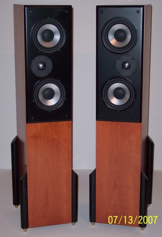

    Default Re: AV120 v BAMTM *PIC*
    > Hey.
    > I have been using a pair of AV120's for
    > several years now and they have served me
    > very well. Ye they aren't the greatest
    > speakers and they were quite cheap. Link to
    > AV120's
    > (http://www.acousticsolutions.net/product.asp?ID=3).
    > Now, i decided to upgrade to some BAMTM's
    > designed by zaph as i heard plenty of good
    > things about these things. But just to test
    > them out i mounted them in the old AV120
    > boxes, the high notes sound so great and
    > detailed! but there is literally no mid or
    > bass notes! is this soley down to the
    > enclosures or what? (I am building them by
    > the way, just wanted to test!). I sure hope
    > so because this sounds not so great .
    > So for newbie question
    I'm assuming you're using Zaph's crossover? You may have something wired wrong. I built the tower version of the BAMTM's and I have no complains about mid or bass output. The DA175 is a excellent speaker for the money. If the crossover is wired correctly I'm sure you will be satisfied.
    HTH
    Dan
