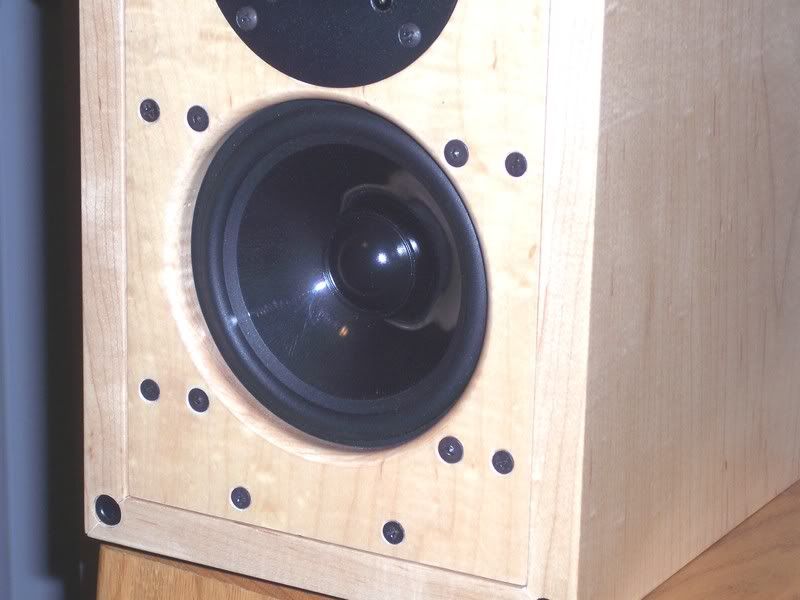

    Default Re: Anyone use the Aurum Cantus 6 inches mid-bass? *PIC*
    I made these for a neighbor and gave them away before spending a lot of time with them. However, it was pretty obvious that the AC-130MK2 is a very high quality driver. Voices were very clear and natural sounding. They are a bit more expensive than other quality drivers of this size, but they have excellent build and I think the quality of the sound easily justifies the price.
    I know that Jeff B. has used the AC-130F1 and he was very impressed with the high quality of the midrange and was able to get good bass from his design.
    It would be interesting to know if anyone has compared the two drivers with a suitable crossover. Looks like the same frame and motor, just different cone materials.
