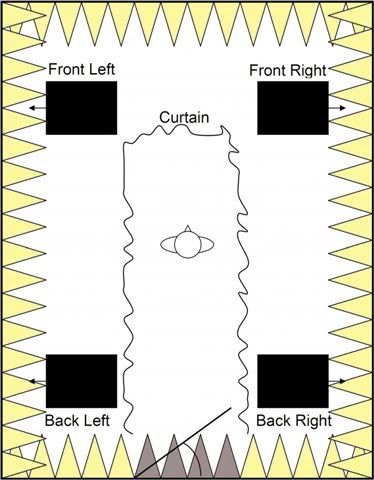

    From the article:
    The test was conducted in an anechoic room – except that the anechoic criterion of this room is not satisfied below 250 Hz. The room dimensions (to the surface of the anechoic lining) are 3.6 m x 4.5 m, with a height of 2.5 m.
    Reverberation time was measured as well, but I did not bother capturing an image of the graphs.
    Harmonic distortions were attempted to be controlled for in the article as well via using moderate SPL levels (65dBA).
    An image of the room from the article:
    With regard to stereo subwoofers, of course, there will be room/subwoofer and subwoofer/subwoofer interactions. Proper placement, room treatment and if needed equalization can mitigate these issues.
    Andrew
