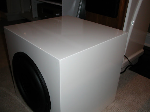

    Here is an example of rushing the finish. If you look in the right top corner of the front baffle you can see the seam of the 1/2" MDF. It also shows on the top right rear corner. This didn't show up until about two weeks after it was finished.
