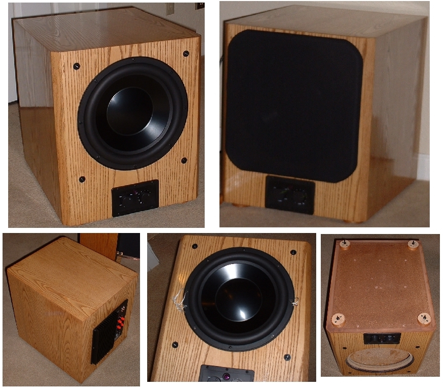

    Default Re: Lets see your RS315HF builds
    --80l
    --Sealed
    --Downfiring
    --Active EQ to boost low end
    --Amplifier above TV
    --Speaker Terminal on bottom
    End table on left
