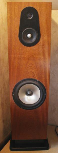

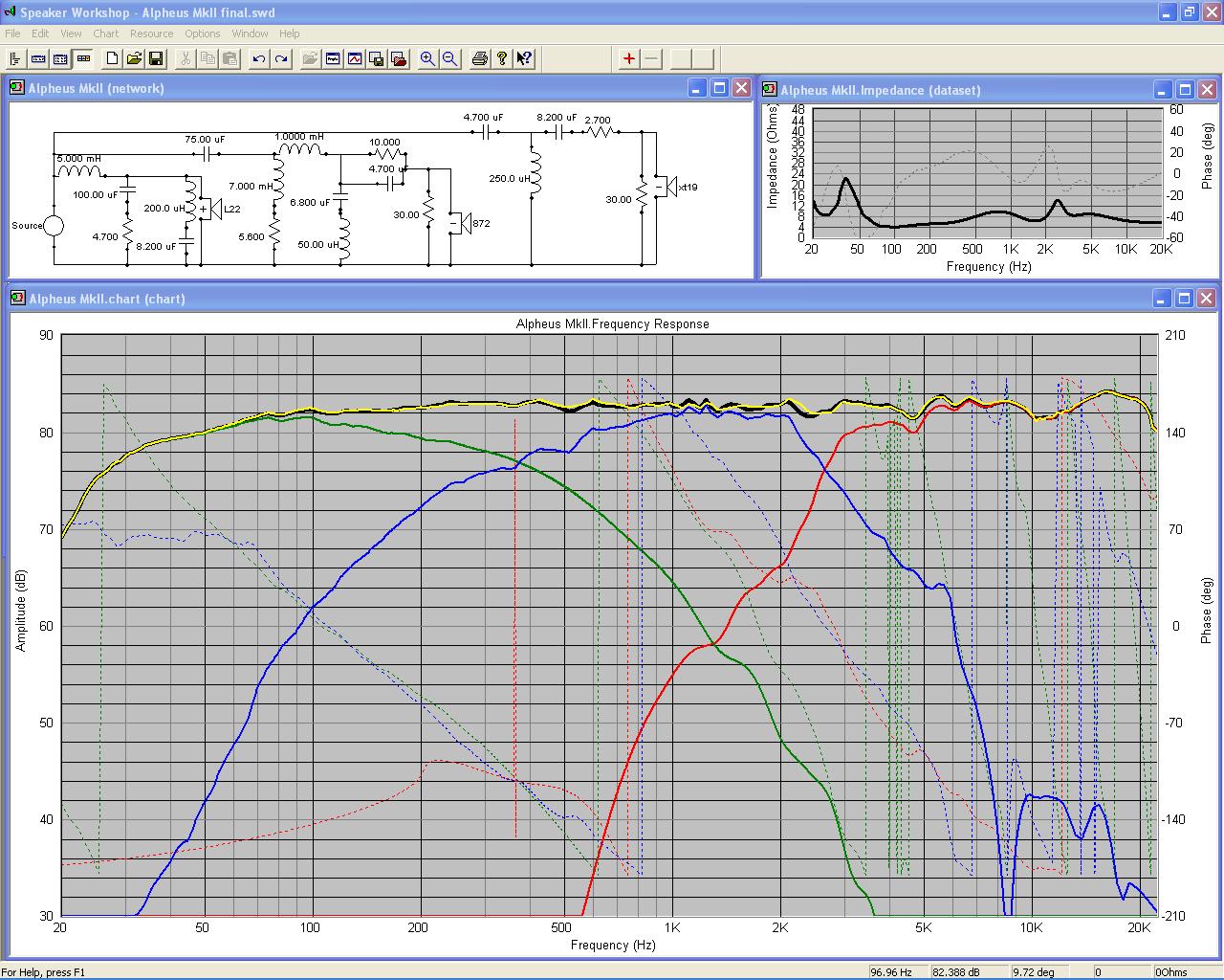

    I'm bummed that they don't have the 830881 in that list (but do have the 5.5" version, the 831882) because that has been the unobtainium part of my beloved Alpheus MkII three-way project. I'll add that any woofers in that line (HDS/phase plug) are phenomenal in my opinion.
    They do have a "substitute" driver (830872 - http://www.parts-express.com/pe/show...TOKEN=77362029 ) that can be used with the Alpheus MkII design (I adjusted the crossover and a few people have built this version with success). The modified crossover is shown below...
    ...and the remaining details for the project are under the Alpheus MkII project link at my site below.
    I apologize about the self-promotion of one of my projects but there are very few projects on my site that can still be built (due to driver availability) and this one is still one of my all-time favorites.
