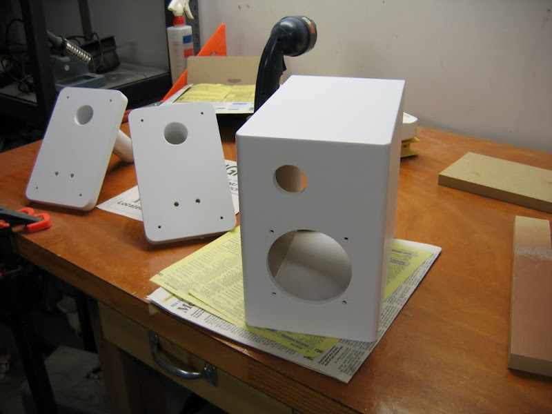

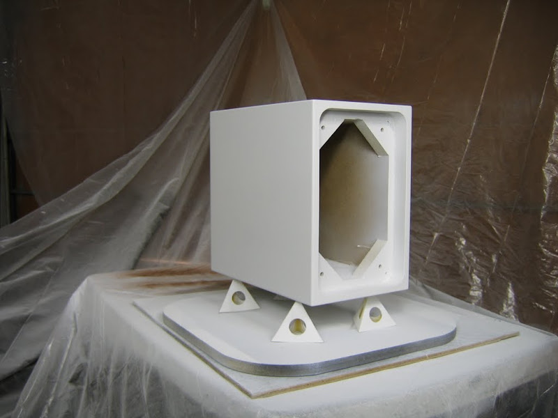

    3 coats of Rustoleum white primer

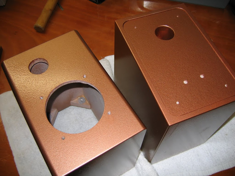

    Rustoleum Hammered copper. (One of these days I'll stop cheating with the textured finishes... )

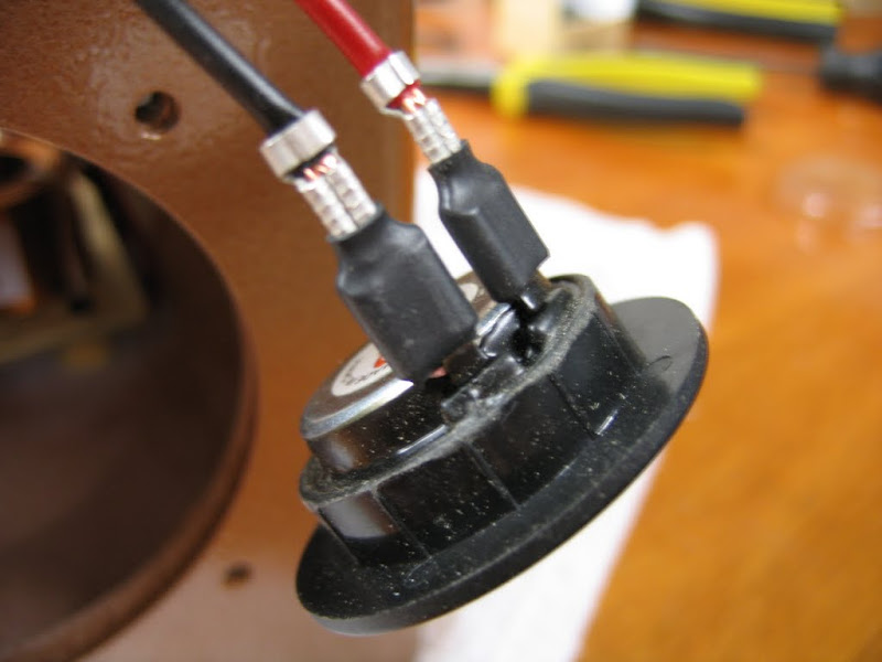

    The terminals were mighty close to the metal housing, so some heat shrink was in order to guard against shorting.

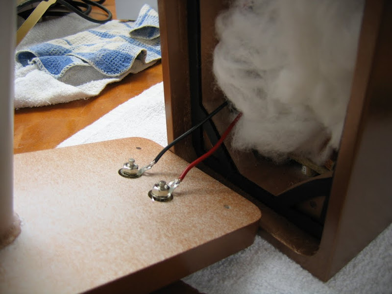

    Gasketing to seal rear panel
    Post terminal solder
    One handful of fluffed fill

    Nice Job! Question though........With the offset tweeter....Did you try them on the outside? I've always been under the impression that if you're gonna toe em in, the response is a bit smoother with the tweets on the outside.

    Actually, I have not.
    My last project were the Tritrix MT's, and Curt saw the picture with the tweeters on outside, and scolded me.
    I will try it though. I also need to pull out a bit of stuffing to see how that sounds.

    Question - it looks like you have a nifty crimper of some sort because of the quailty of the terminal crimps. Could I inquire about what you used for that?

    Question: why no bracing? I know I'm a bit of a maniac when it comes to bracing, but I would have thought that even just one brace side-to-side would be a good idea.

    Quote Originally Posted by williamrschneider View Post
    Very nice job!
    Experimentation with the stuffing has a significant effect on the sound of these. The removable back will come in handy for that.
    I honestly don't remember where I got these.
    If there's one thing I can do well, its terminate wires with solderless terminals. (10 years as an aircraft electician).
    I like these because of its bite. Notice the sharp dip in the top. That does a good job of angling the metal downwards into the wirebundle. Makes for maximum contact and grip.
    And those terminals with the extra tangs to grip the insulation are great. Best terminals PE has. Forget the insulated ones.
    PE #095-522
    errr...
    because Paul C said so? honestly, he mentioned that because of how very small these cabs are, no bracing was necessary. And since I am [still] an idget regarding design, I took him at his word.
    I can already tell, I am going to get pretty good at building other designs, LONG before I can completely design my own, or even understand all the theory involved. Its getting a bit frustrating...
