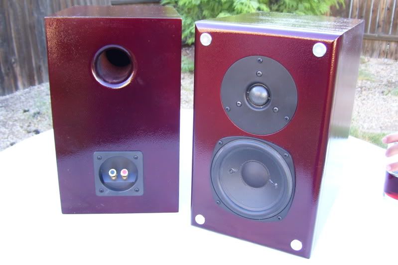

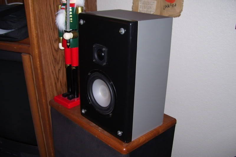

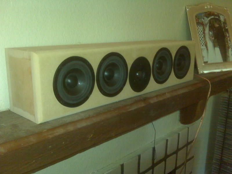

    Here are some of mine, for some reason I can't find the Center Channel that I built for my friend, but here are the rest....
    GoldBooks--Goldwood GW-S525/8 + HiVi TN25
    Deuteriums--Definitive Technologies 5.25" PE Buyout + Dayton Silkie, Box alignment by Wolf, XO by Shawn A
    Audax/Tang Band Center Channel Audax AP100ZO + Tang Band 25-669SD 2.5 way
    Triska sub, with odd sized box... SD215-88 DVC subwoofer + 2 SD215-PR Passive Radiators
    Currently working on the Duellati, a Dayton DA115-8 + SEAS 25TAFC/D MTM. The boxes are being built and the XO is modeled, but I have to get some coin to get the parts, aside from the tweeters, which I already have.
    Enjoy!

    Nice stuff, Mark. I thought I'd show a pic of the DefTech 5.25" woofers I used with an old buy-out Seas aluminum tweeter, 25TAFCD. Shawn worked up the XO for me and I came up with the ported box alignment using WinISD. About .25 ft3 net volume. I was not successful AT ALL with any of textbook XO's I tried, nor with any of the XO Pro alignments. I had quite a few very good references to compare with, so I knew how awful those algebra-derived and XO Pro XO's were. Thankfully, big Shawn said he'd do a XO if I sent him the tweeters. I sweetened the deal by including the latest hardcover copy of "Moto GP Technology" by Neil Spalding as a surprise. The SQ was light years beyond anything I tried or what XO Pro came up with. They're now on loan to a girlfriend of mine for her art studio. Some folks are just as interested in those speakers as they are her amazing artistic ability. I have 4 of those DefTech's left, so I want to try that silkie version.
