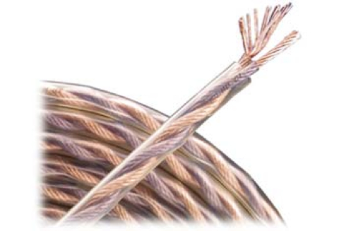

    A question about wires. I want the wires to look sweet. Rounded would be better than flat side by side zip style wire. The runs should be fairly short <5ft each, so about 10ft total, but I cant seem to find wire that looks good. Anyone have a suggestion for twisted pair wire? Gauge recomendation? I was thinking 14-16.

    yeah pe has a close out on wire I will find a link. your wire in the hole of the post idea is good.
    http://www.parts-express.com/pe/show...number=109-040
    use the pair as one wire cost is 5 dollars for every 25 feet it is 18 gauge 2 18's = 15ga. I have a link for my favorite wire costs more has a great name canare and a very nice feel to the jacket

    I have some of the canare in my attic. I could send a small sample to you for free. I would have to look. over the years I have come to think the lower the cost the better the wire. thus the closeout was my first choice for you.
  19. #19
    Default Re: Apple themed Overnight Sensation MTM
    Quote Originally Posted by philiparcario View Post
    Thanks for the links! A sample of that wire would be awesome. A picture might work as well, if you can find it. I am going to try my local audio places and radioshack. I have some neat looking blue/silver twisted monster cable for a sub in my car I found there before.

    Here is a picture of monster cable sold at radioshack that looks pretty cool.. though its 100ft which is more than I need.
