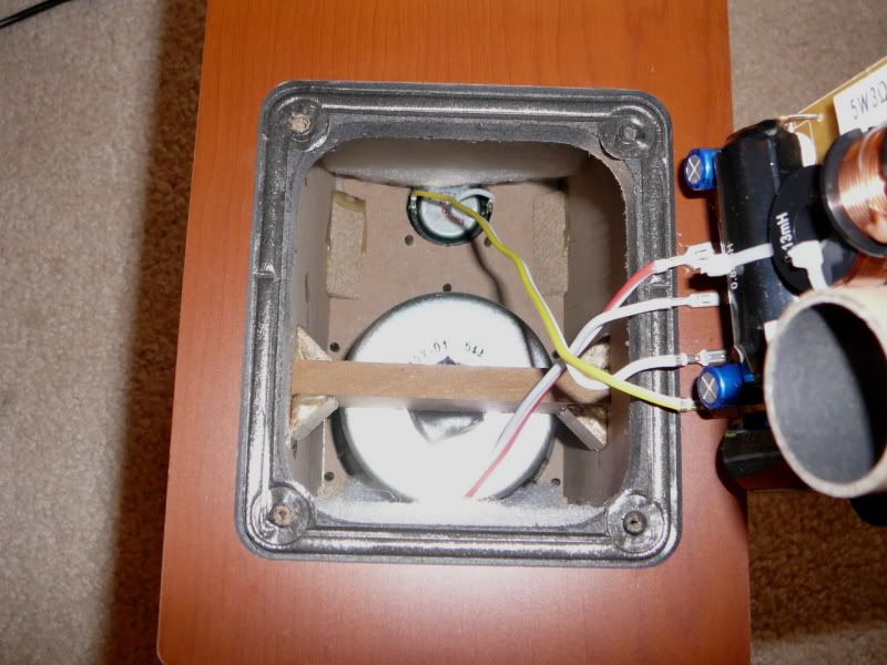

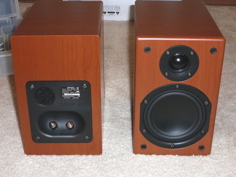

    I've been saving this for a slow day, and while I am waiting to get on the road to Ft. Wayne, here are some pics of the pair of Denon Speaks I got with a mini-system.
    [img]http://i123.photobucket.com/albums/o289/RHB3III/Denon%20SC-M37%20Gutted/DenonBookshelf1.jpg[img]
    These are very sturdy braced little cabs wrapped in vinyl laminate that is sorta simulated cherry wood. Drivers look to be Peerless/Vifa/Tymphany type. These sound pretty good, but are a little scratchy on top. Having a look at the Farfield FR curve, there is a bit of lift in the top octave that is probably causing that. At first, I thought: "cheap tweeter" but I think a simple parallel RC on the tweet will bring them from "fair mid-fi" to "pretty good."
    Cheers / Robert

    Looks pretty solid. Decent drivers and a real crossover. What price level did the system sell at?

    Seriously, a braced cabinet, real crossover, decent drivers, I'm kind of impressed. Usually, when I open up some generic commercial setup I'm amazed at the lack of "guts".
    Even my B&W 602's have only a single coil on the woofer.

    Denon remains a silent competitor to "high end" brands - and they usually make a better product, too.

    This was my hotel stereo while I was working in CA for 4 months. When I bought it, I expected the speakers to stink, while the receiver/CD player/amp to be standard upper-midlevel Denon quality. I was really surprised; these'll be good with a little high cut and maybe a little more damping in the box...
