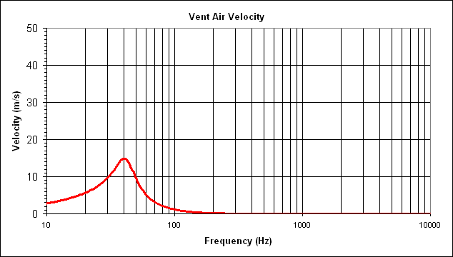

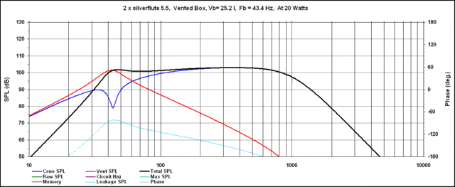

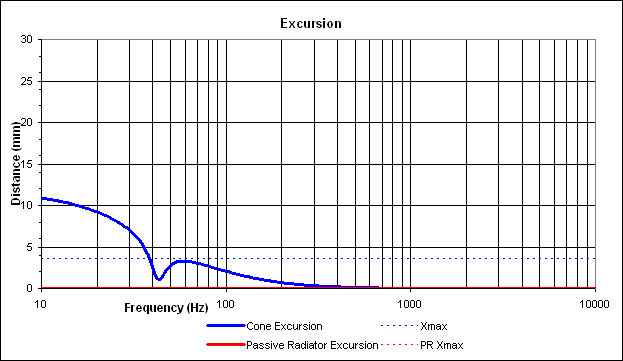

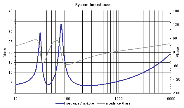

    it seems i have these boxes to work with.they measure 39.5/8x75/8x83/8 h/w/d. mtm with one vifa dx25, http://www.parts-express.com/pdf/264-1020s.pdf, and two silverflute w14rc25-8 in parallel, http://www.madisound.com/store/produ...roducts_id=842
    using wb&cd i used 39.6x7.6x8.4 for 25L with a 3x11 port to get;
    fb 40hz
    f3 40.5
    f6 37
    with 20 watts i got these
    as you can see these have no back so i have options. could i do somthing like curt and wayne did with the tritrix? would i even need to? other thoughts are welcome.
