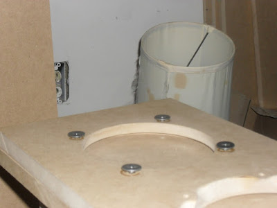

    I just finished up re-vamping my subwoofer box to go from a sealed to ported design. At the same time I decided to replace all the screws with socket cap bolts and hurricane nuts. What a PITA. I drilled everything out nicely and installed them with a C-clamp. They seemed nice and tight. I went to install the amp first and on the second to last screw, the nut just spun and I couldn't get the bolt back out. Had to cut the head off with bolt cutters. Happened two more times before I got everything installed. I ended up ripping most of the hurricane nuts back out and putting wood glue or epoxy on them before reinstalling. I may not be able to ever get my sub or amp back out, haha. I also 45 deg chamfered all the enclosure edges, re-did the finish (Duplicolor truck bed coating), and flush mounted the amp. I'll get some pics up soon.
