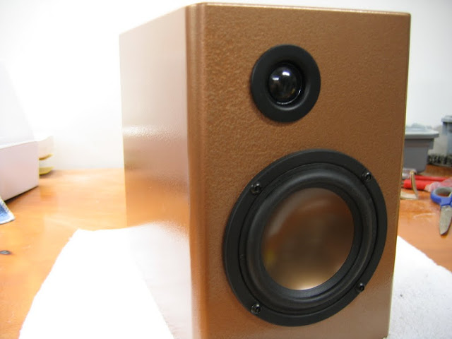

    Rust Oleum hammered paint looks pretty good without much effort. I re-did the OSMTM in "hammered copper" when I gave them to my cousin for a graduation present; looked nice. Forgot to take a damn picture, though. Here's a photo of the China Syndrome in hammered black.

    Default Re: B_Rich's Build Thread
    And here is what they look like in hammered copper...
  14. #14
    Nice match to the drivers Ck that looks stunning.
    Oh man that does look really nice ckmoore.
