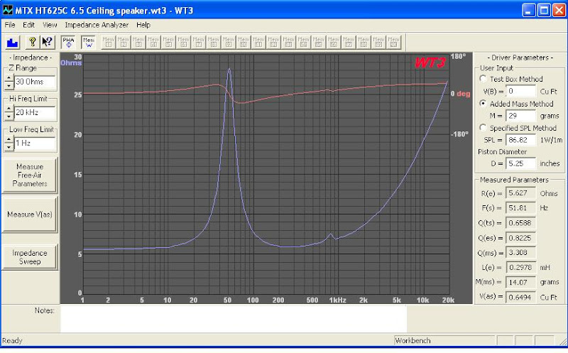

    Just thought I would follow up. I broke them in and hooked them up to the WT3. Looks like they like a vented box best. Win ISD is using the ceiling spacing with two speakers in it.
    Dave

    Measured these with the mic sitting off to the side about 10' away with the speakers sitting on my work bench leaning against my damping panels. Just to see what the way off axis was. Kind of how you would be sitting in the room away from the speakers. Surprisingly not bad.
    Dave

    Where were you last week! Drywall is up, taped with one coat of finish. No holes cut yet. Two layers of R13 in the joist space. I do still have the end open outside the room so I could slide something into the space I think.
    Messing with Win ISD I could put one 4" vent 2 inches long between the two and that would flatten the peak. I don't see these being used at high volumes. More for Christian music.
