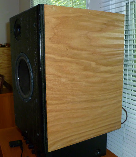

    Finished boxes came out all right - I'd decided that I wanted a black baffle with light sides and top. Used a 3/4 inch ply for the baffle, and (per LouC), hit it with sanding sealer, Krylon satin black, and Krylon satin clear. Sides were finished with a couple of coats of Deft satin.
    Here you can see the imperfect match of the brad nails with generic wood filler.
    My wife was SO kind, she said they were very beautiful, that she didn't know I could make something so perfect. (aaawww....)
    UPDATED BAFFLE PLACEMENT INFORMATION:
    One of these days, I should post a nice drawing. For now, this is what I built:
    Overall baffle dimensions: 9 1/2 W X 16 H
    NS6 woofer: centered left to right (4 3/4 inches), center of woofer is 9 inches from the bottom of the baffle.
    Vifa BC25 tweeter: 14 inches from bottom of the baffle to center of the tweeter, tweeter center is offset left of right of baffle center by 1 1/4 inches (mirrored offset per pair). Or you can think of it as the edge of the tweeter is about 5/8 down from the top, and about 1 7/8 in from the respective left or right baffle edge.
    Port is centered left to right on the pack, center of hole is about 4 5/8 down from the top of the box.
    Last edited by donradick; 03-07-2012 at 02:44 AM. Reason: added drive placement on baffle.

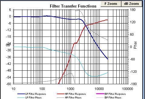

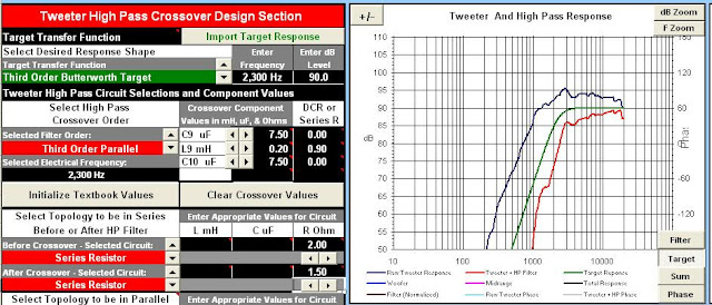

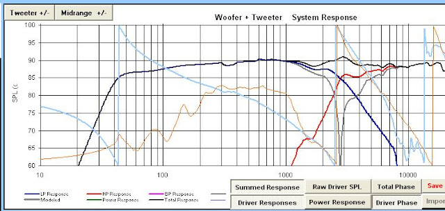

    I learned a TON about simulation and modeling on this - thanks once again to Jeff Bagby, Wolf, and Paul Carmody. Here are the PCD screen shots with all the details. I went through many crossover revisions - finally settled on stock values as much as possible, and played with the resistors in the "legs" to get a decent frequency response and good phase matching. I found that as little as .1 ohm would really affect the null. I finally got a 50 dB null, and decided that was as good as it gets.
    Null actually goes to 50 dB. I really don't notice the slight bobble around 1-4 K, and the bass does not sound like it drops - which is probably due to imperfect BSC modeling on my part.
    Woofer crossover and low pass
    Tweeter crossover and high pass
    Filter transfer functions
    System Impedance
