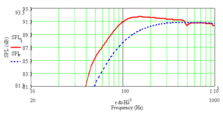

    This is the response I got by using measured parameters. Not much bass in this 14" H, 10" D, 6.5" W (internal) box.
    The port is 2" dia. X 5" long and located AT the bottom of the box. The driver is centered 3.64" from the other end of the box.
    I'm building 6 of these.
    I'll be watching for anyone who will post a x-over suggestion.

    How does the excursion look in that model at about 25 Watts Ed? I modeled them in smaller sealed enclosures and they behave well staying under published xmax at 25 Watts and 101 dB. An F3 of 74 Hz says they would be okay high passed and augmented by a sub.

    16 W is enough to drive the unit to the 3.5 mm Xmax. Output with that is ~104 dB.
    I think these really need to be crossed @ 80 Hz and above. YMMV
