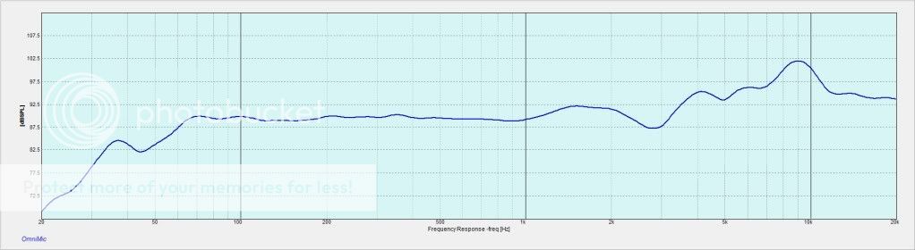

    Sony SSM-B350H Frequency Response

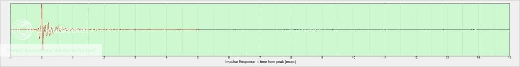

    Sony SSM-B350H Impulse Response

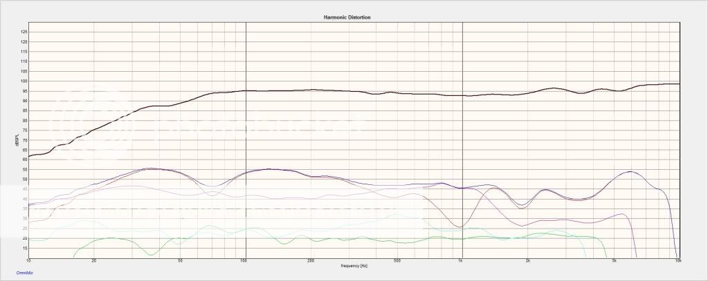

    Sony SSM-B350H Distortion Level.
    Black is the fundamental, red is the 2nd harmonic, Magenta is 3rd, green is 4th, light blue is 5th. Dark blue is the composite harmonics.

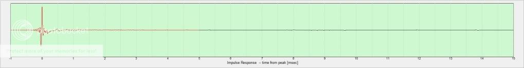

    Impulse Response of ADS L500

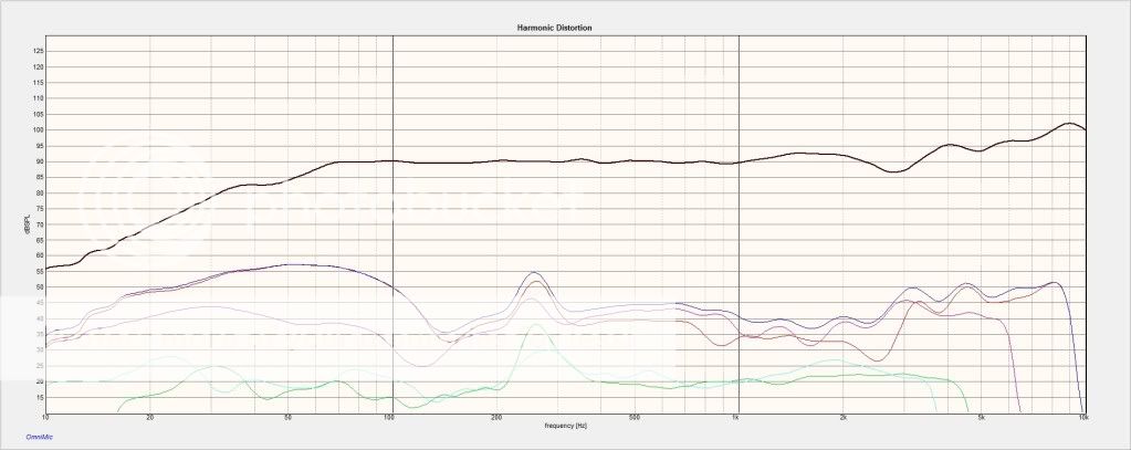

    Distortion of ADS L500
    I always liked these ADS speakers more than the Sonys. I thought they were a nip bright but not a bright as the Sony but what I really noticed though was the ADS had much less listener fatigue. Taming the brightness on the ADS is a simple twist of the treble knob on my amplifier....the Sony can't be tamed with a 12 band EQ! The huge spike in 4th/5th harmonic in the lower midrange is likely to blame as vocals always sound funny.
    It's really pathetic that 25+ years of technological progress hasn't allowed Sony to prevail or at lest compete here. Sure, the Sony is cheaper than the ADS but the materials are *far* more advanced on the Sony. Cones made of Polyolfen/Kevlar composite, drivers with a molded polymer chassis and nano materials in the tweeters are all for naught on this design. The ADS is smoother in frequency response, faster and has less high harmonic distortion where the ears are the most sensitive. To add insult to injury, it did all that with one less driver, a paper woofer with a stamped frame and a soft dome tweeter that looks crude by today's standards.

    Yes, the closer distance might cloud that high end, though a ragged and hot high end was/is common with a lot of commerical speakers, and your ears are backing that up. Its probably not quite as hot as it looks, though
    Distance... You're always trading off between very close, to get a clean low end, sans room interaction, and off a goodly distance for a realistic pic of the mid to high end. Then you stitch together a couple of those measurements for an accurate full range FR. I think there's still a section on Zaphaudio where he describes doing that process in his Soundeasy and how I use it, section.

    As the others have said, but keep in mind that at such a close distance your driver integration may not represent how the speaker was designed, or would measure or be heard several feet away. It may also emphasize the higher frequency response, which may flatten out quite a bit a few feet away as well.
