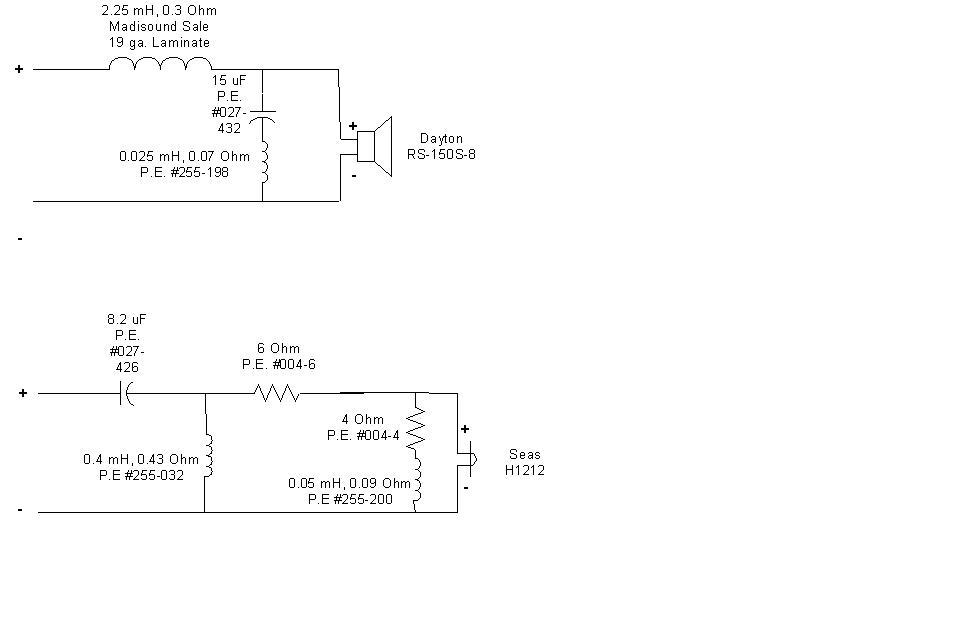

    Alright, so here's the parts list I came up with for the Seas version. I downloaded some zip file for the RS28a version, but the files only open in gedit (Linux notepad) and I can't figure out how to figure what I need as far as cross over parts from it (they list a bit weird). I assume I may need JeffB's program, but I'm on Linux and I doubt it works with LibreOffice. Anyways if anybody knows where to point me to for the xover parts for the rs28a or could tell me which of the below to change I'd appreciate it:
    2.0 mH Air Core 18ga
    .35 mH
    15 uF
    4.7 uF
    6.0 Ohm
    .60 mH
    10 Ohm
    Thanks!
    Bruce
    .35 mH
    15 uF
    4.7 uF
    6.0 Ohm
    .60 mH
    10 Ohm
    Thanks!
    Bruce
    I've got the schematic at home. But I do believe the woofer XO is the same in both versions, and the RS28 needs one extra capacitor.
    I can respond later if Jeff doesn't happen to respond before then.

    OK, Dreydel with RS28A
    RS150-8:
    2mH .6 Ohm
    12uF
    .25mH .2 Ohm
    RS28A:
    4.7uF
    .45mH .2 Ohm
    25uF
    Then, in series with the tweeter, a parallel network of 1.5uF and 5.5 Ohm.

    Anywhere I can find a schematic or picture? I aint too bright and like perdy pictures.
  16. #16
    Join Date
    Oct 2005
    Location
    Ballwin, MO 38.597554, -90.547423
    Posts
    16,669
    Blog Entries
    1
    Default Re: Dreydels vs CJD vs C-killa...?
    Attached Thumbnails Attached Thumbnails Click image for larger version.
