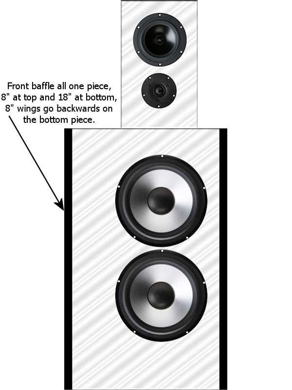

    You should look into H framing the 10's, you'll get a lot more low end out of the woofers. Instead of hoping for 100 Hz it'll prolly get down into the 40s or 50 Hz.

    I would put the mid on a 7 on 8 inch wide, long (20 to 30 inch ) baffle centered with the tweeter above and offset for minimum diffraction with the Edge baffle modeling. I have the Vifa NEW123s mounted like this and they sound wonderful.
    I think the Daton 10" aluminum driver you mentioned is great driver for the bucks and I have one in a sealed box and like it fine. I think the baffle below would work well with no changes except the driver cut out diameter.

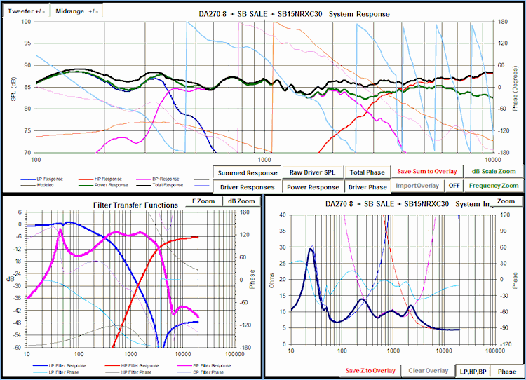

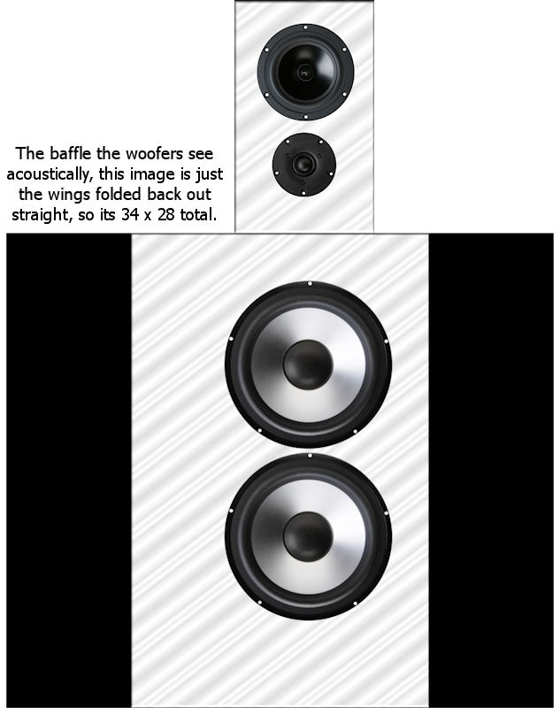

    Ok, so looking at adapting my design vs. reinventing it totally, I've come up with this below. I'm starting to model it now, but it looks like it'll be -6 db at 45 hz or so. This will let me push the subwoofer XO further down if I don't mind trading a bit of total output SPL loss in return.
    The design:
    What the woofers see acoustically:
    So I'm using a model as if the woofers are on a 28" high and 34" wide baffle now, though an actual measurement would of course be better. Linkwitz mentions a curved sides design like this on his pages to approximate a circular baffle, so I don't think I'm too far off base by simulating this way. I'll post again when I have a PCD simulation of this version.

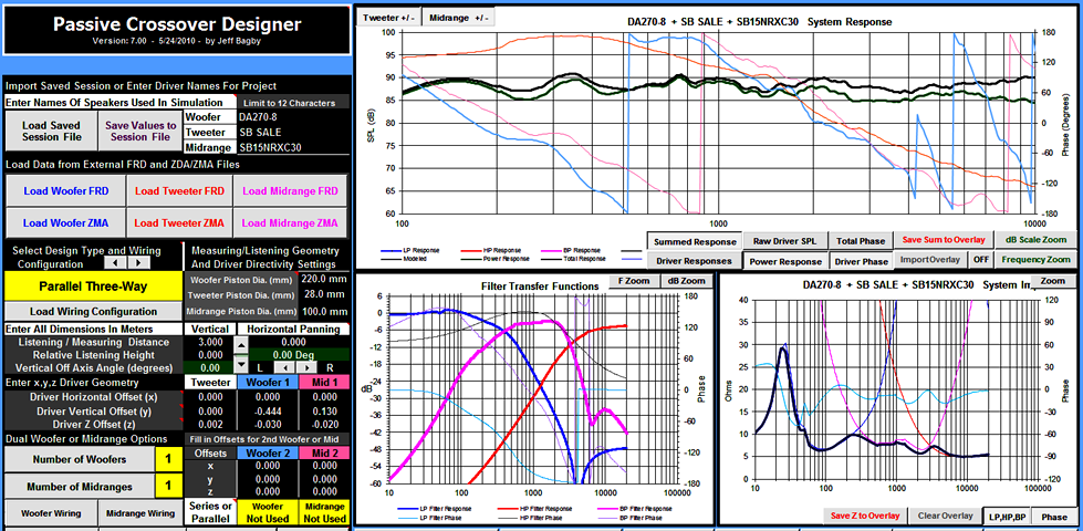

    Ok, so after reflecting on the design, and feeling like I'm treading into unknown waters with the OB dipole design, I scaled back.
    Its currently got on DA270-8 10" woofer, the amazingly cost-effective SB15NRXC30-8 5" midwoofer used as a midrange, and the SB TWD25 budget tweeter from madisound.
    I feel pretty good about this, and it looks like I only lost a bit of low end extension (doesn't matter in this application) and sensitivity as it comes in now at 87db 2.83V @1M. Also, leaving the bottom part of the baffle open means designing an active box sub for it later means I can integrate it

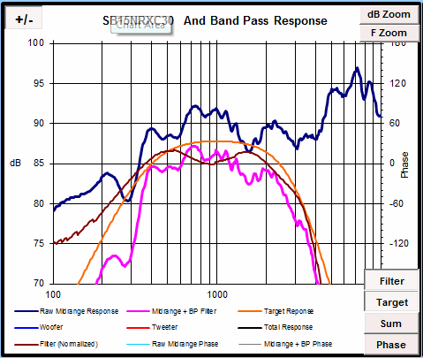

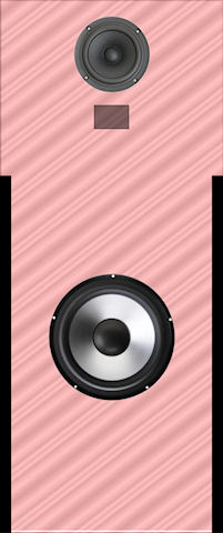

    Ok, so I'm get more and more excited about this build. I'm hoping that when I trimmed 200$ off the cost it will be an increase in cost-effectiveness. If the baffle design works well, you'll see me build many more versions of this speaker with different drivers. Since this one will have a copper metallic paint baffle with gold paint gilding, I'm calling it "Gilded" Here is the final design for the baffle:
    I don't have a good pic of the TWD25 tweeter, so I just put a rectangle that describes its outline in the design. I centered everything and went back to the full wide baffle. Reason: It was easier to compensate for the baffle peak in the XO if both the woofer and mid saw the same boost. The woofer and mid distance is a function of the width of the baffle too, they are exactly 50% further apart than the baffle is wide. This had an noticeable effect on the crossover slopes and overall response. Of course, this is all just modeling, so who knows.
    The real problem I'm facing is the woofer. Its not really seeing a 43" x 18" baffle, or a 28" x 32" (like it would if the 8" deep wings/legs were extended) and I don't think it counts as a U-frame because its missing a top. So I modeled the driver both ways, and plugged them into PCD and tried to model an XO that looked good for both. Eventually I settled on this:
    Which I think looks smashing, look at that phase! The electrical and acoustic is just damn smooth. The crossover is a 400 hz LR2 and 2800 hz LR4, and the reverse null is quite solid too. I think I hit the LR4 on the money, because there are nulls at +/- 30 degrees vertical. The response +/- 15 degress is damn nice though, with just a small drop across the 200 to 2000 range.

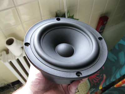

    I had the chance today to sit down and rest after makes all the cuts for the boards that will become the speaker (+ matching subwoofer) and I took some time to examine the SB Acoustics SB15NRXC30-8 visually. All I can say is:
    damn.
    I mean, it's an impressive looking driver. I was floored by the fact that it isn't even wearing any underwear - you can look right down into the voice coil. Wild. Let me share some speaker porn, each image leads to a full-size (huge perhaps?) version if you click on it.

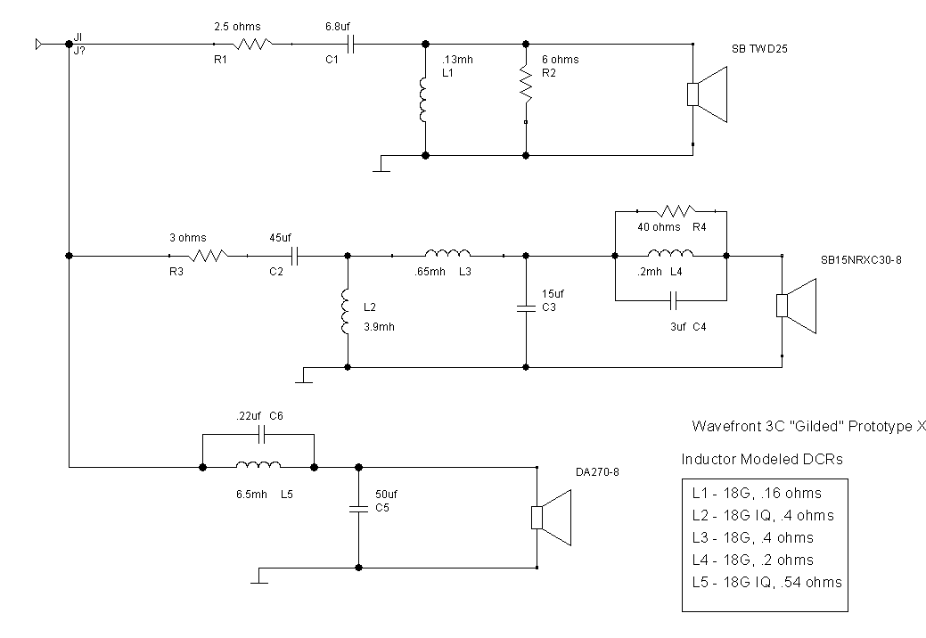

    More details to follow, but I'm on crossover 2 now. I hadn't properly compensated for the baffle gain which was quite audible. After that, I still had this painful ear hurting quality from behavior about 1 to 2 khz with any volume. I tried various models, various designs, and various thoughts. However it turned out to be my own stupidity. I never routed out the back of the holes for the midrange to let them breath. When I would just walk behind the speaker at any volume, you could hear the offending sound from the back. I imagine that works as a loaded chamber at those frequencies if its not chamfered to open the back? I'd be interested in the acoustic science of that issue, maybe I'll start another thread.
    All I can say right now, is that man they sound natural. They are so clean and power hungry I find myself using the output meter on my ASUS sound card so that I don't overload my amp
    Alloy Foundry of Wishray - JasonP75 Flicker Stream
  11. #11
    Default Re: Wavefront DIY OB Dipole Speaker
    "Since the DA270 isn't putting out (efficiency) what the model says" Oh man. Let me laugh sickly for a moment.
    Hahahahahahaha. *sigh*
    Ok, so during assembly, I made one major misstep. In the model the midrange and tweeter are reverse polarity :/ I give you one guess what I forgot during hookup.
    Alright, so the DA270 is putting out as promised <.< Now that its not getting canceled by the phase issues in the 200-400 ranger >.>
    I tell you what, hammering the midrange into shape in a dipole design passively is a challenge. Even more so when you are fighting peaking right outside the pass range in the same XO. Oh my.

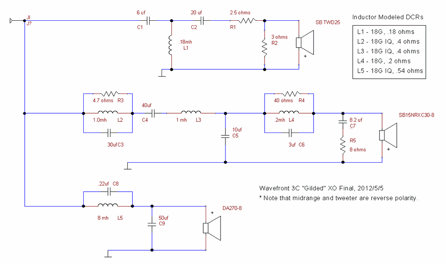

    However, I think I have it now. Everything has come together, and I just spent yesterday voicing tweeter level and adjusting the 3 khz crossover to relax the sound.
    That is the result of days of music listening covering everything from acoustic live to JPop with the help if the equalizer in Foobar2000. Yes, there are TWO damn parallel notches on the mid, one for the baffle and one for the breakup. I tried to use a 3rd order low-pass without the notch to simplify but then phase wouldn't work.
    I'll post screen caps from PCD 7 with the final XO next. My impressions of this final version are: wow. These are the best small room speakers I've ever heard, even at volume they don't scream or overload the room (the reason I built dipoles). They really and truly impressed me most with movies. I've never felt the impression of a theater at home before, and these do that awesomely.
    Oh, I should note that L2, L3, and L5 are all solid core inductors to keep the DCR low and the expense reasonable, ERSE IQ in this case.

    Ok so the current model in PCD:
    This seems to be the best solution I could come up with that is pleasing to the ear. You can see that the mid/tweeter XO moved down to 2.7 khz and the slopes improved, the phase is nearly perfect slightly off-axis (since you listen above the tweeter, which is 32" up from the floor). There is only a single cap on the mid, and so there is a huge peak in response at 45 hz or so from the resonance. The thing is, I'm filtering at 80 hz to a sub, so I don't care. If you did, you could put a shunt 10 mh coil right after the 40 uf cap and it'll take care of that.
    To show you the nightmare I was dealing with in regards to the mid, here is the baffle response and the final response:
    Now to get the baffles finished, XO boxes or such built, and so on!

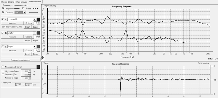

    Ok, ECM8000 and mic mate arrived today, I have no idea what I'm doing, but fumbling through the guides on this forum, I ended up with this:
    I ended setting the gating so that it crossed the impulse at 2MS, just before that second wave of garbage appeared. The response has N=6 smoothing, and I'm unsure I can trust the THD with this setup. The measurement is on tweeter axis at 2 meters in their normal position near the walls.

    Looks alright, I'll be the 2 spikes in THD are caused by panels rattling, try bracing the wings a bit more.

    Thanks for looking it over. I'll see what I can see about panel resonances, and also I noticed that all these type of designs I see online have a brace running on the back to better support the drivers. I wonder if that would help. The peaks are 2nd order, when I show higher order distortion they go away.

    They have those shelf brackets at the big box stores you could check those out, or cut some 45 braces and screw those in.

    This design is canceled, pending a possible total redesign, as I just discovered the source of the honking that has been plaguing it in my listening sessions: basket reflection. Unlike a closed box, the reflection/compression space formed by the basket and the cone aren't absorbed into the box stuffing but released into the room. I did some length measurements of the basket depth and cone geometry for the SB15 driver here, and its the same frequency I have to turn down on my EQ to make the honking go away: 3700 hz or so. If I crank them up and stand behind them, you can hear the emphasis there being radiated out into the room. I could redesign with a better tweeter and much lower XO, but frankly I want to work on the Boson using what I learned here instead. I'd make a sad face, but really I'm so happy to figure out what is happening is eclipsing the sorrow.
