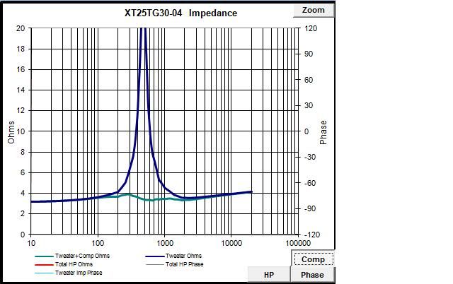

    What's the tweeter Z look like? You're -3dB at 2kHz already, and the notch will help, so you may be okay. I'd still listen for nasality as-is.
    Johnny- sometimes a double-notch is warranted. The effect of a resonance or energy storage usually has to be 'shorted out' after the voltage dividing lowpass. (If you want rid of it completely anyway.)

    Here's the tweeter Z with compensation.
    That spike is NUKED.
    I still want to try third order electrical on the woofer, and when I get some free time I will. Probably not until Friday, at least. I'll post what I get out of that, as well, but by all means, keep letting me know what you all think, based on the current posted info.
