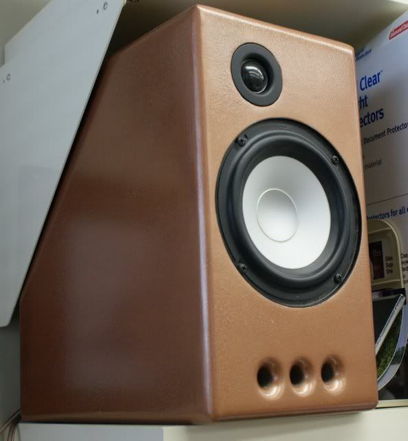

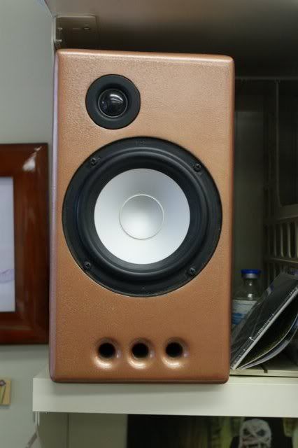

A few years ago, I bought several (6) close out HiVi A5+ drivers and some assorted tweets. The original plan was to build 3 MTM boxes for the HT. half way through, I moved, then plans changed and we went with in-walls. So these sat for some time, then I got around to doing something with them, this is number 1.
This one we will call the overnight INSPIRATION, because the were heavily inspired by the OS. Not a copy of course, but not entirely original either.
They are BR design, tuned to about 45 hz. Because they are close out woofs, I wont bother with the X-over details, they are second order. Cabs are 12mm Baltic Birch, and the ports flared on the outside only.
I run them off a Lepai amp at my desk at work. Sound is really very good, I left the tweeter a bit hot, because I sit off axis below them, and I just give it a bit of EQ if I am away from my desk around the lab. Bass is strong enough to call them full range for the power they see, and imaging is excellent.
