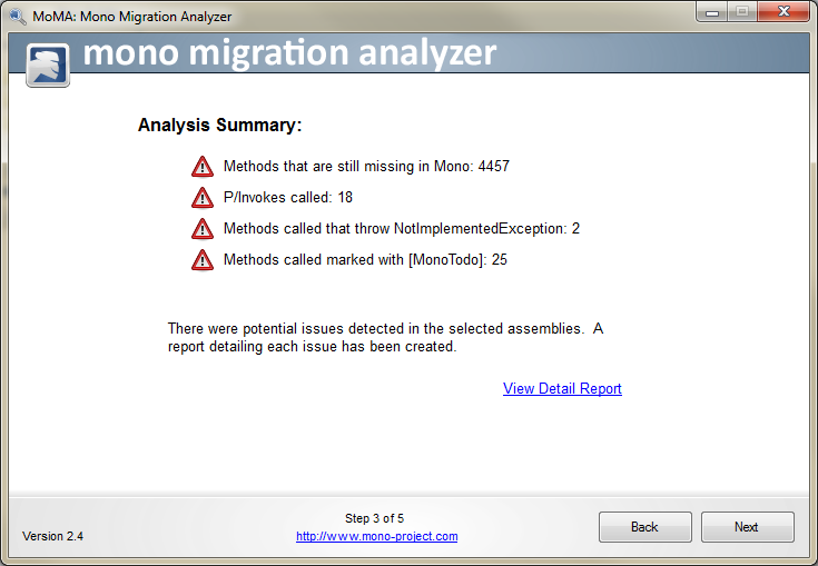

    You can go to http://mono-project.org and download the compatibility checker for converting the .NET CLR code to Mac and various UNIX/Linux platforms.

    Nevermind...This is for PSD_Lite, which uses no external libraries and no database code. Looked like some of the errors could be circumvented with different code constructs, but the sheer number of errors here is not a good sign.

    That definitely has a foreboding look to it. Developing in .NET4 probably increases the likelihood of missing methods.
    I just took a quick look, it appears that it's for C# only on .NET. Despite the CLR, yours being VB may be the issue.
