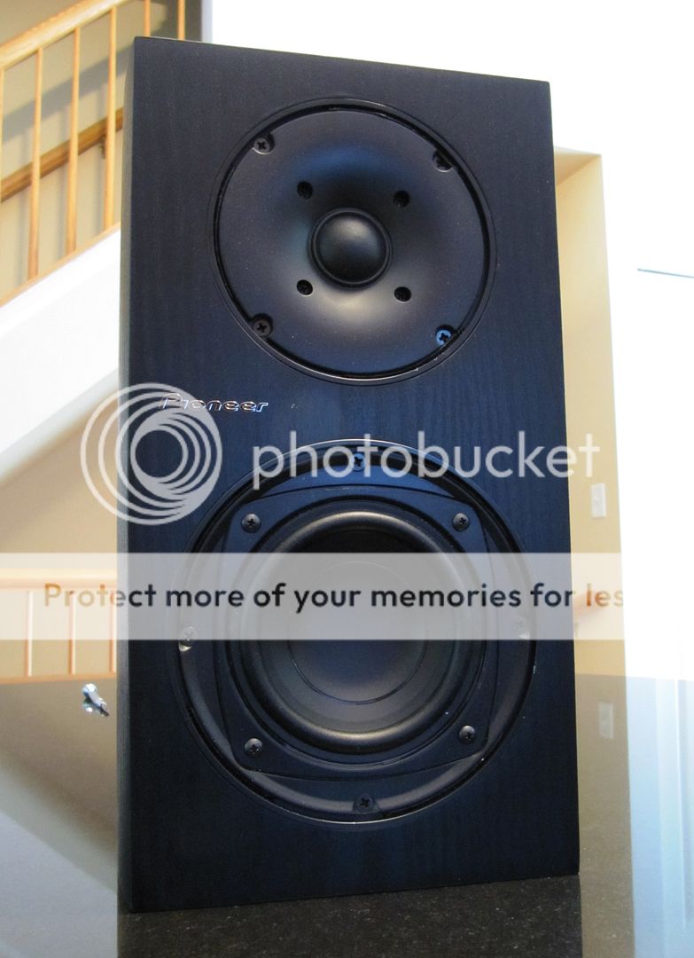

    Today I got a couple tests done and I pulled apart one BS21. Before I go on, I just want to toss out some observations.
    CABINET:
    The cabinet is very decent. It's made of 15mm (0.59") MDF covered in black vinyl laminate (looks like black ash). A knuckle rap test reveals that it could use a bit more bracing. It has a nice square terminal cup with banana binding posts. In order to use bananas, you have to completely unscrew the posts to pop out the little plastic covers. The XO is screwed onto the back of the terminal cup. Upon removing the drivers I discovered that the cutouts are a bit odd, especially for the woofer. The woofer sits in a plastic frame that sits in a 5.65” recess. Dropping test woofers into this will require some custom trim rings. The tweeter sits in a waveguide that is approx. 4.5” round, and the cutout for the tweeter is 3.73”. There is one internal brace from front to rear baffle. There’s some poly-fill in the lower half of the cabinet (just a couple handfuls). There’s no wall lining at all or any stuffing in the top half of the cabinet. The port is 1.5” I.D. x 2.5” with an exit flare.
    DRIVERS:
    No markings on the drivers at all. I’m not good at describing drivers, so I will let the pictures do the talking there.
    LISTENING IMPRESSIONS:
    Here’s my initial (very short and sweet) subjective take on the sound of the BS21’s as compared to my reference Speedsters. Immediately the BS21's appear more efficient but it’s mainly louder in the midrange area. They almost feel a bit forward in the vocals as compared to the Speedsters. They dig fairly deep, but definitely not as deep as the Speedsters. The bass is punchy and definitely there and overall, they sound pretty smooth….no real harshness. I say no real harshness, but it’s pretty obvious to my ears that the BS21’s are a bit hot in the mids, at least as compared to the Speedsters. It may be that my ears are tuned to the Fountek ribbons in the Speedsters which are blatently smoother. I've always thought the Speedsters were a bit warmer in the mids too.
    VALUE PROPOSTION:
    For $100/pair these are worth every penny. For $50/pair, they are a steal, even if you throw out the drivers and XO and reuse the cabinets. I know this will sound biased, but after tinkering with these for a few hours today, I’m not expecting to find a way to make them better than they already are. I’m going to try though.

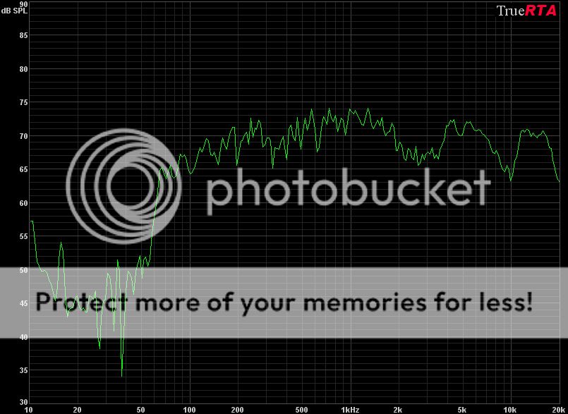

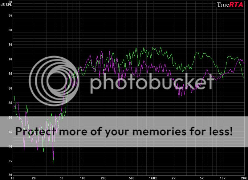

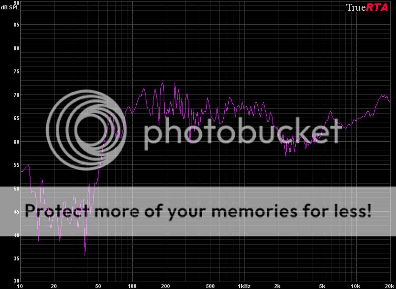

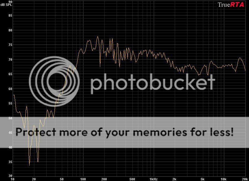

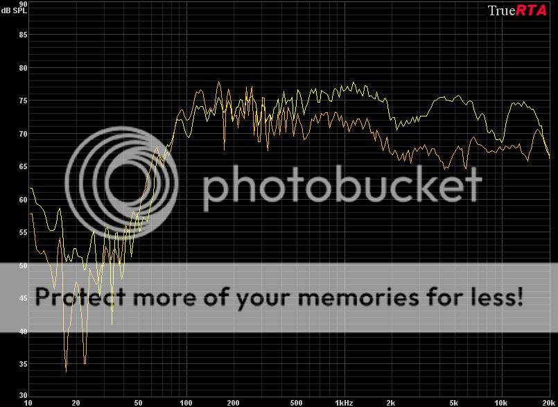

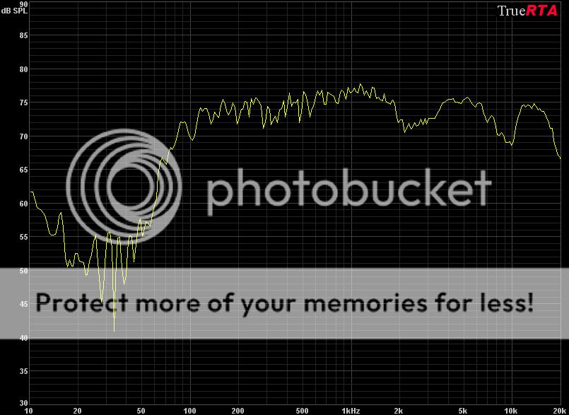

    I am no scientist when it comes to measuring and I have nothing close to an optimal space to do so, however, since this will be a comparison to the Speedsters, the measurements should yield something of value.
    Testing methodology:
    Speaker on edge of table 30” from floor. Ceiling height 10 feet and nearest side boundaries at least 6 feet away. I took two sets of measurements using a quick sweep in TrueRTA, measured with a Cross Spectrum calibrated ECM8000. Both measurements on axis, mic lined up in between tweeter and woofer – 20” away and then 10” away. I also measured port response with the mic right at the port exit.
    BS21 - 20"
    Speedster - 20"
    BS21 - 10"
    Speedster - 10"
    20" comparison - BS21(green) - Speedster(purple)
    10" comparison - BS21(yellow) - Speedster(gold)

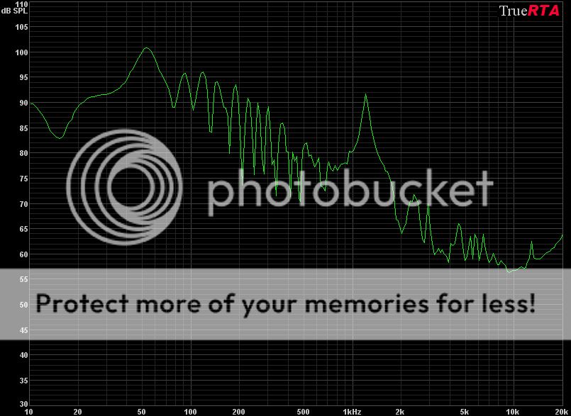

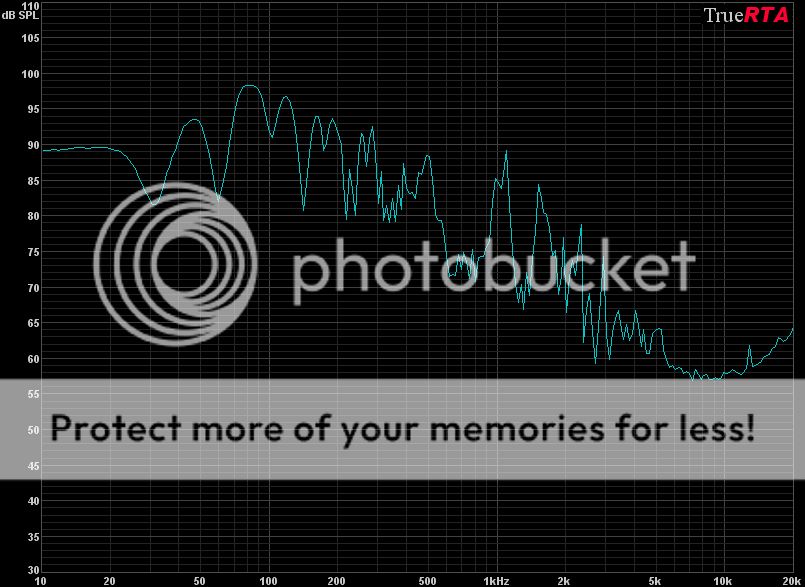

    BS21 - port
    Speedster - port
    Port comparison - BS21(blue) - Speedster (green)

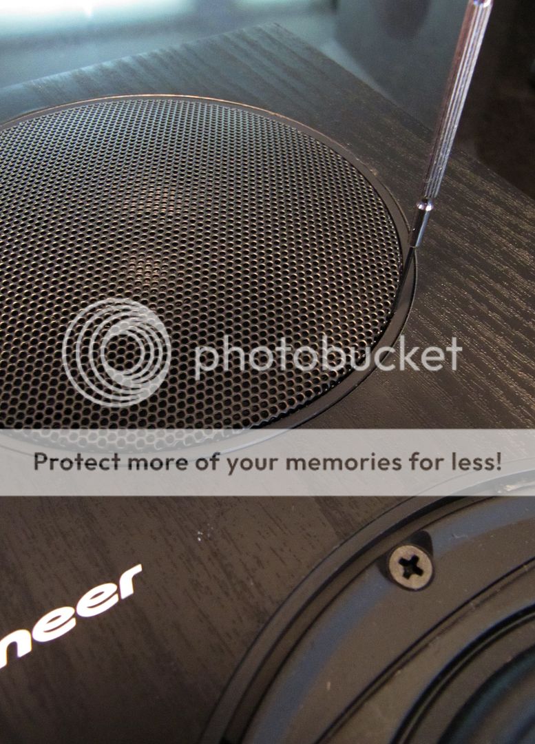

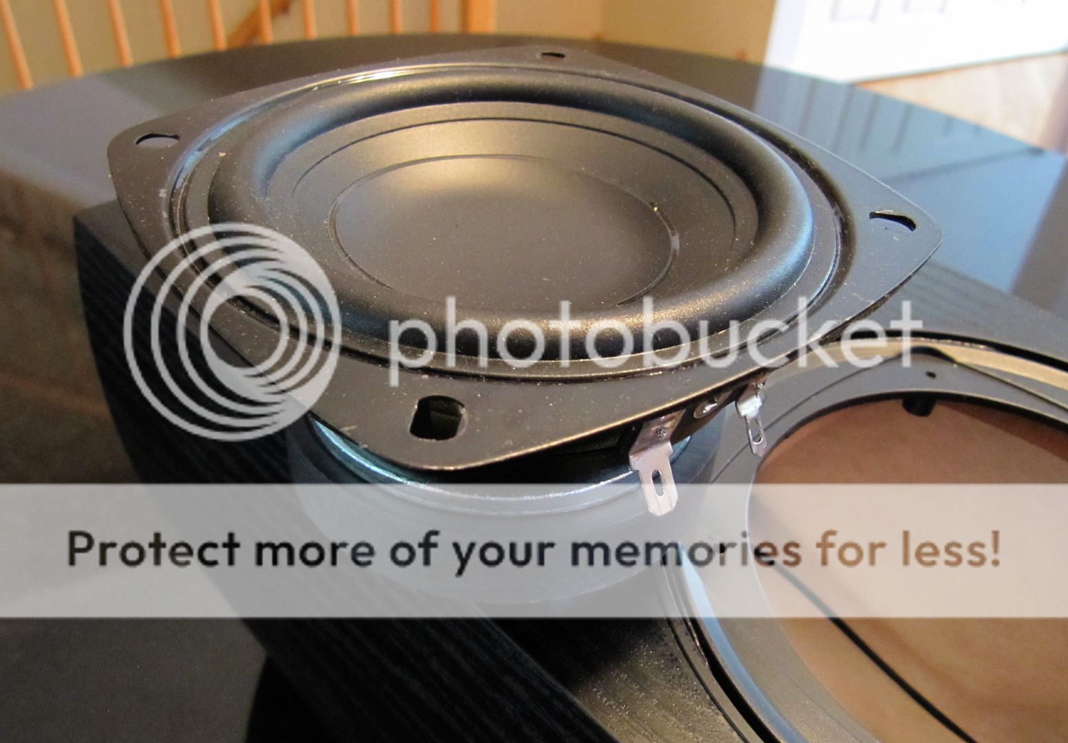

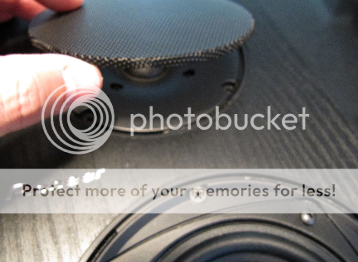

    DECONSTRUCTION:

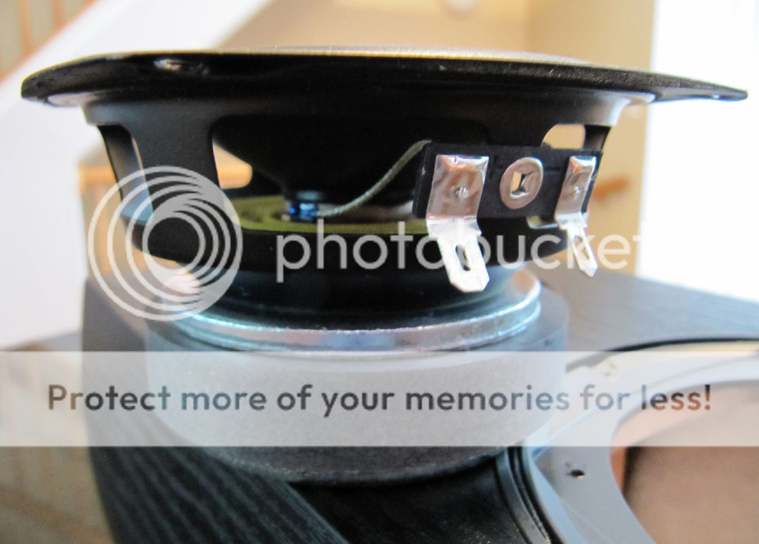

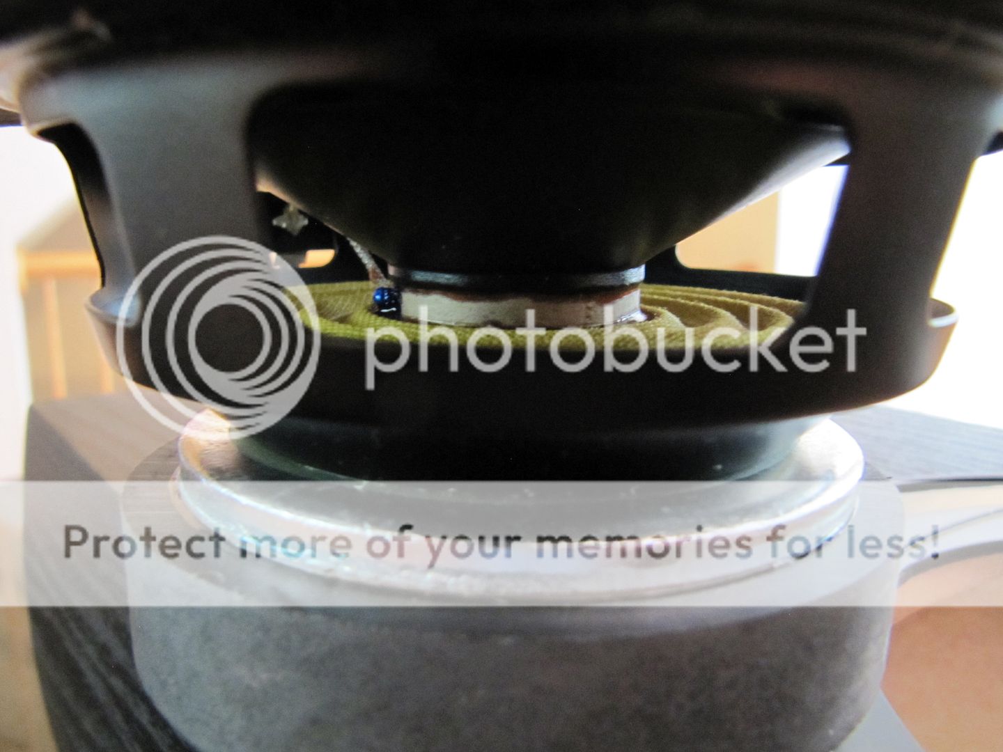

    Used microscopic screwdrivers to pluck the grills off. They are held in with what appears to be butyl rubber.
    Speaker terminal cup with XO attached to back side.
    Woofer out – note the plastic frame.

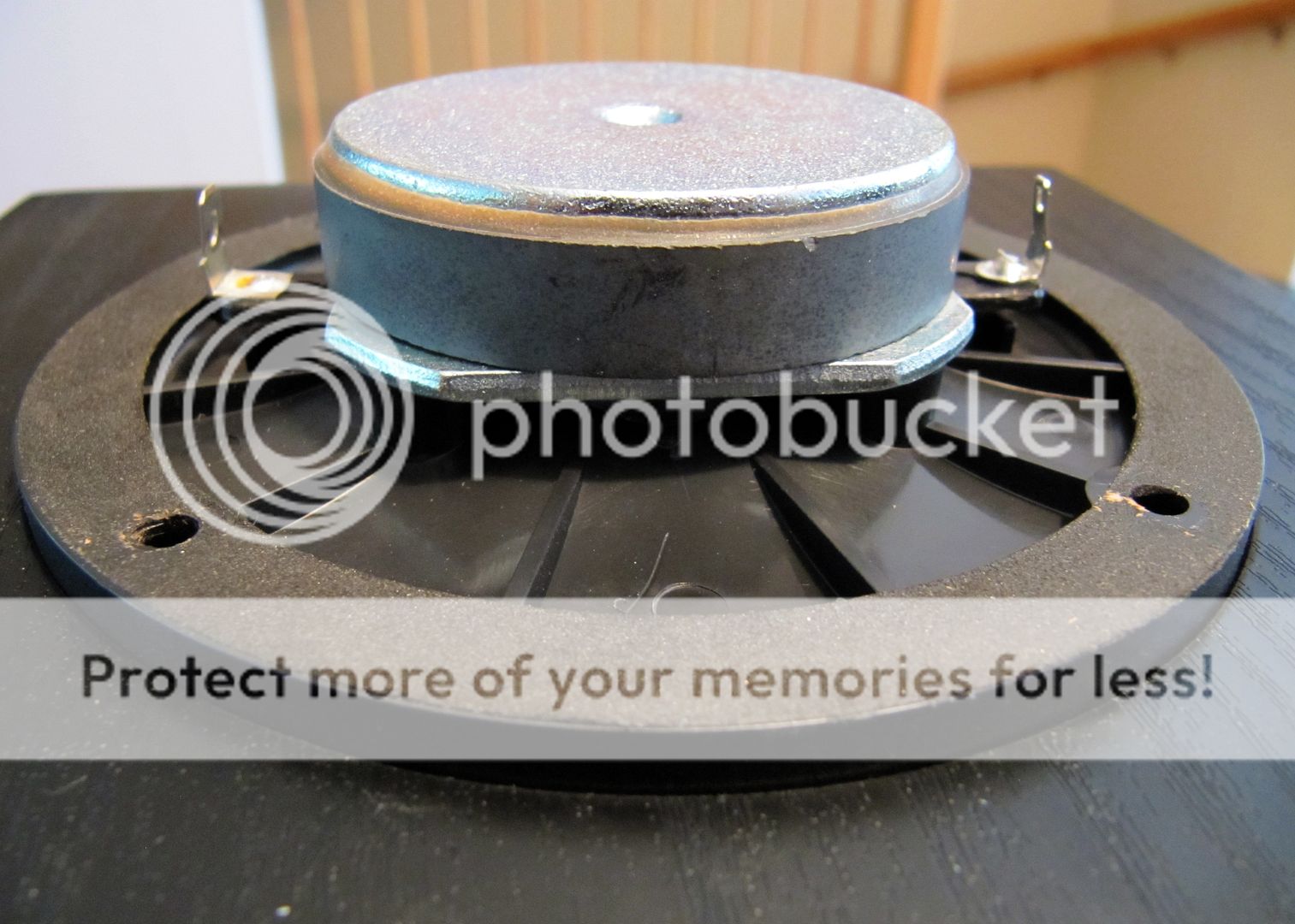

    Tweeter removal.
    Tweeter removed from waveguide.

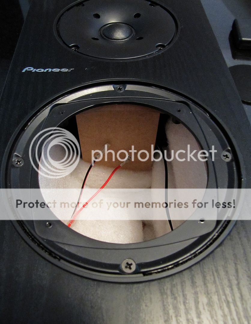

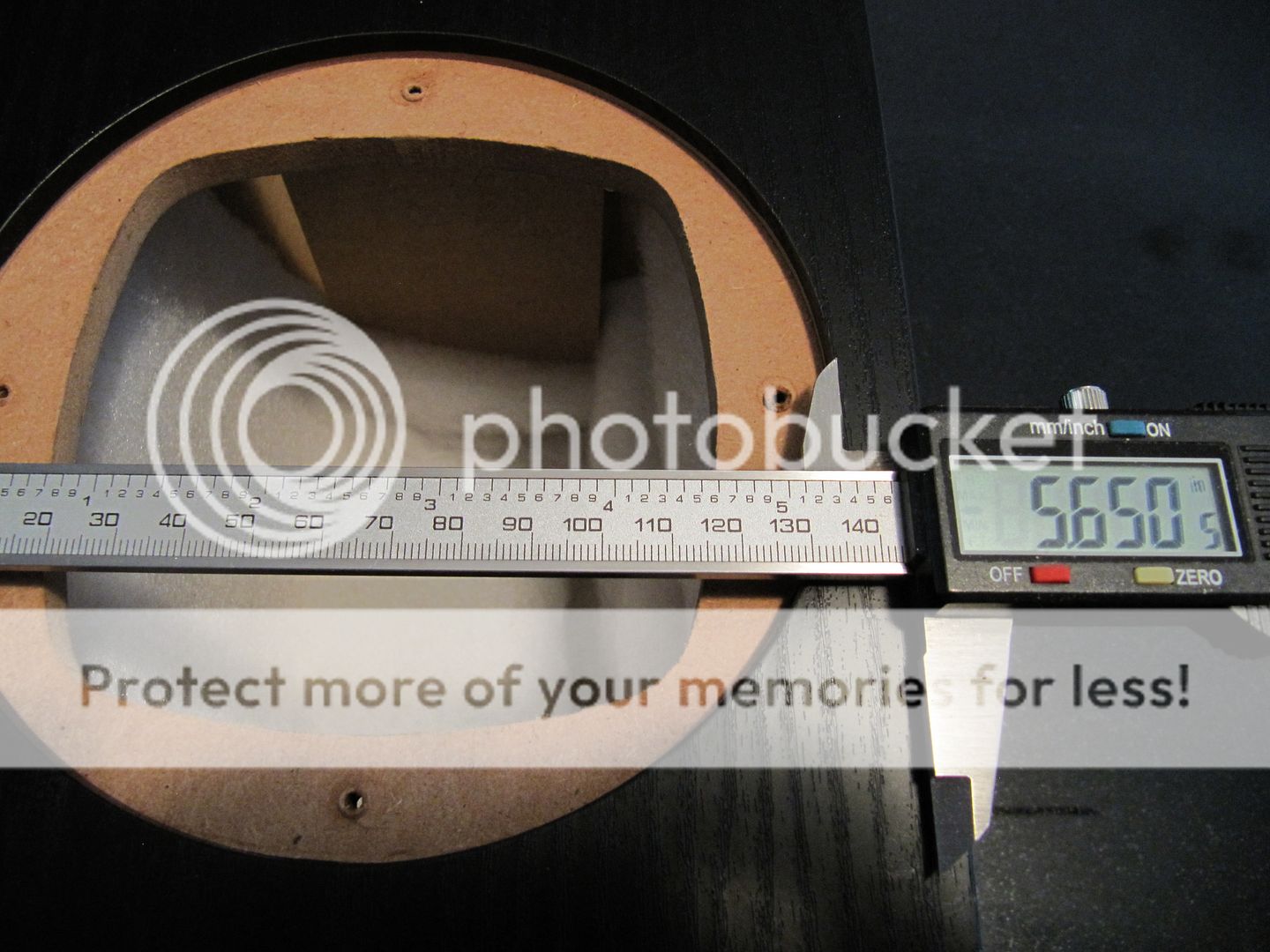

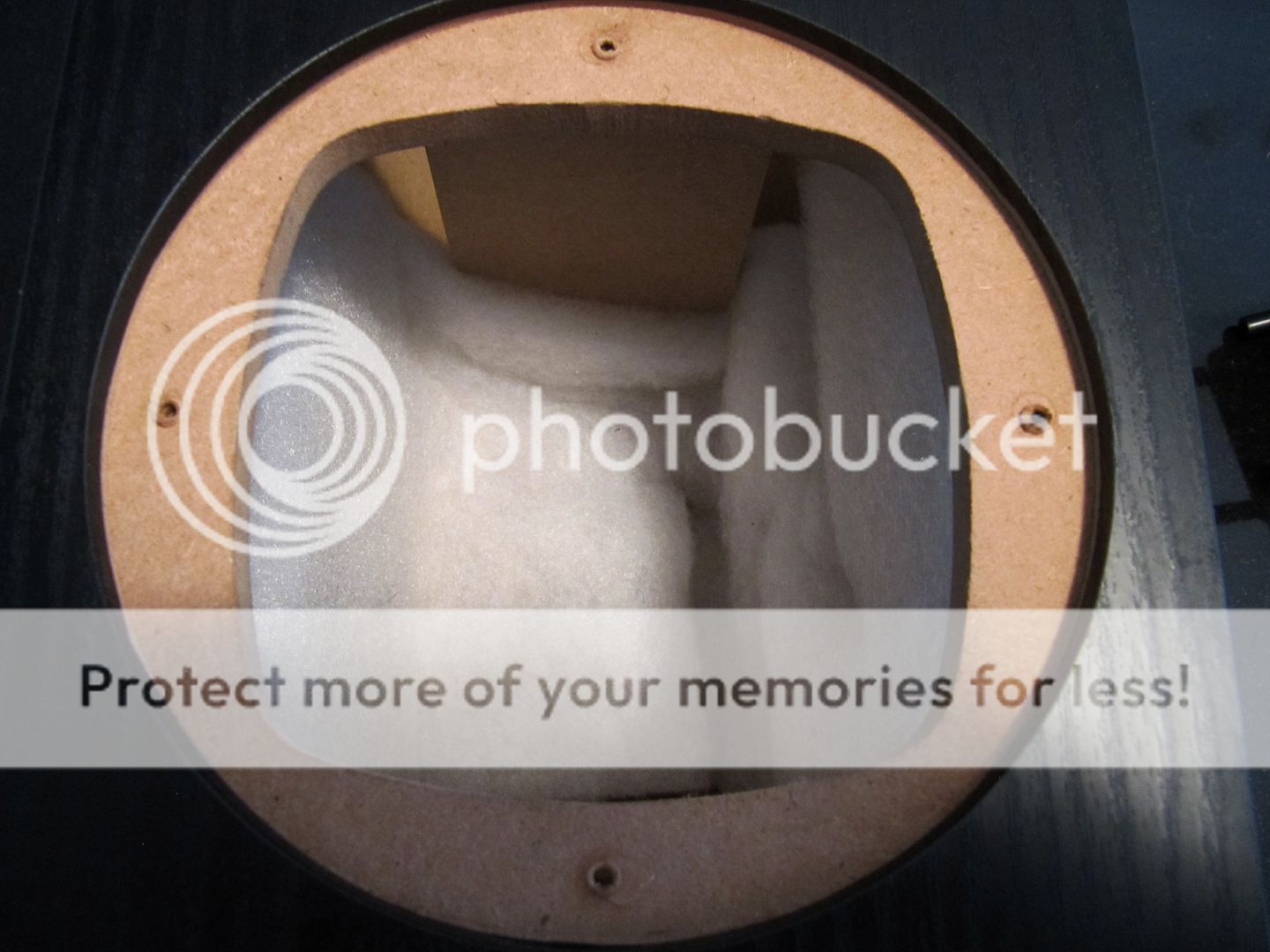

    Plastic frame for woofer removed. Note the singular baffle brace and the small amount of poly-fill.

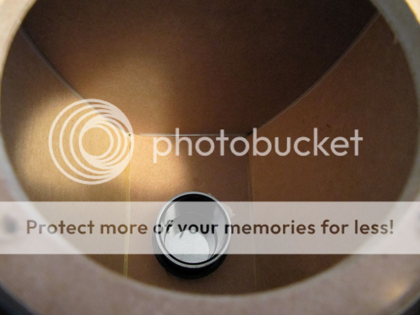

    Top half of cabinet, looking thru tweeter cutout. Note the 1.5” I.D. x 2.5” port.

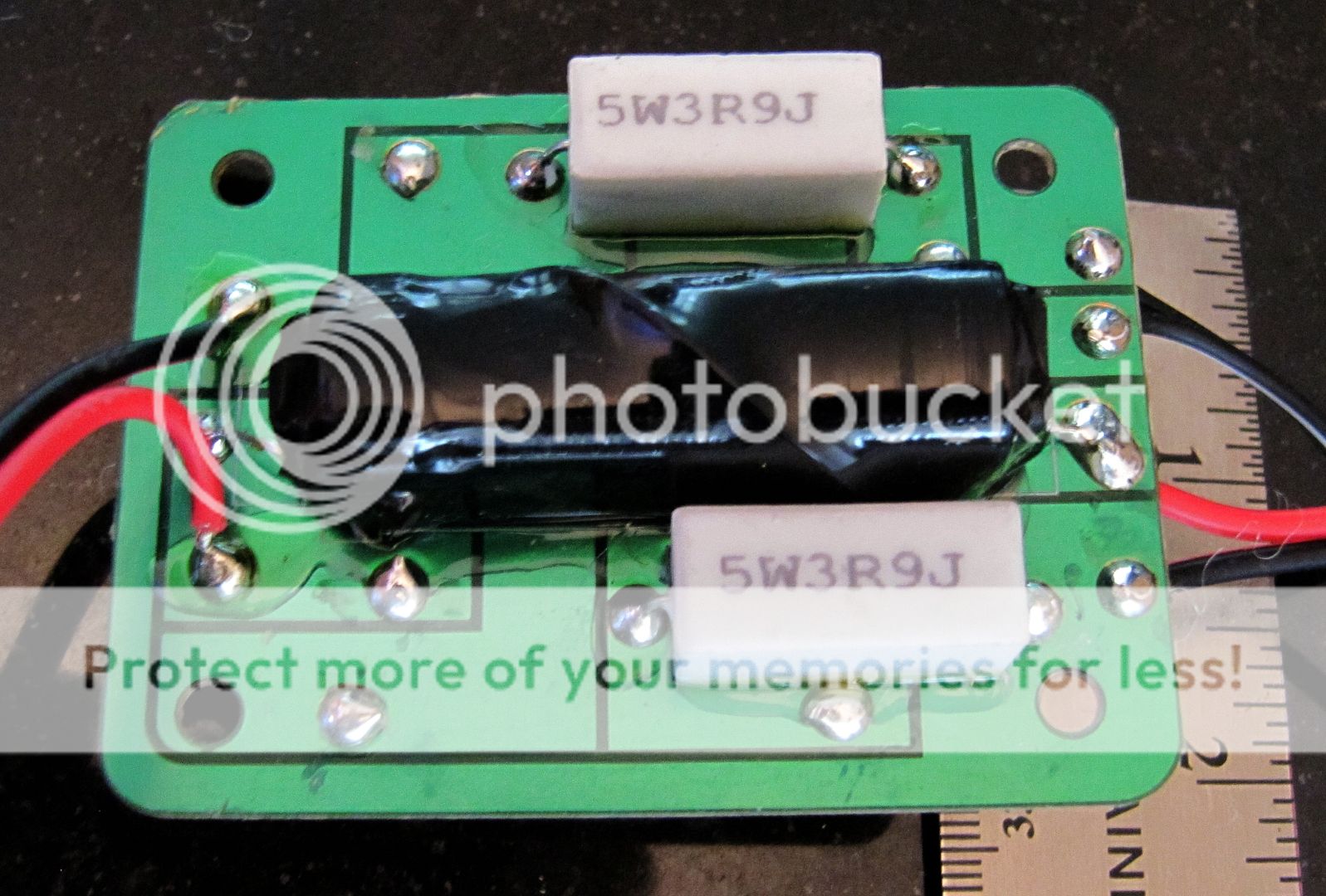

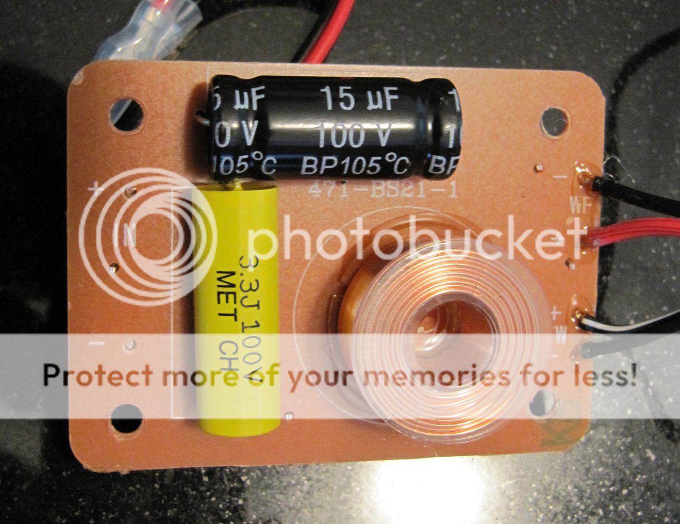

    Crossover – double-sided on a PCB – 6 elements – uses a NPE and a poly cap, an air core and a steel core inductor and two 5-watt resistors.

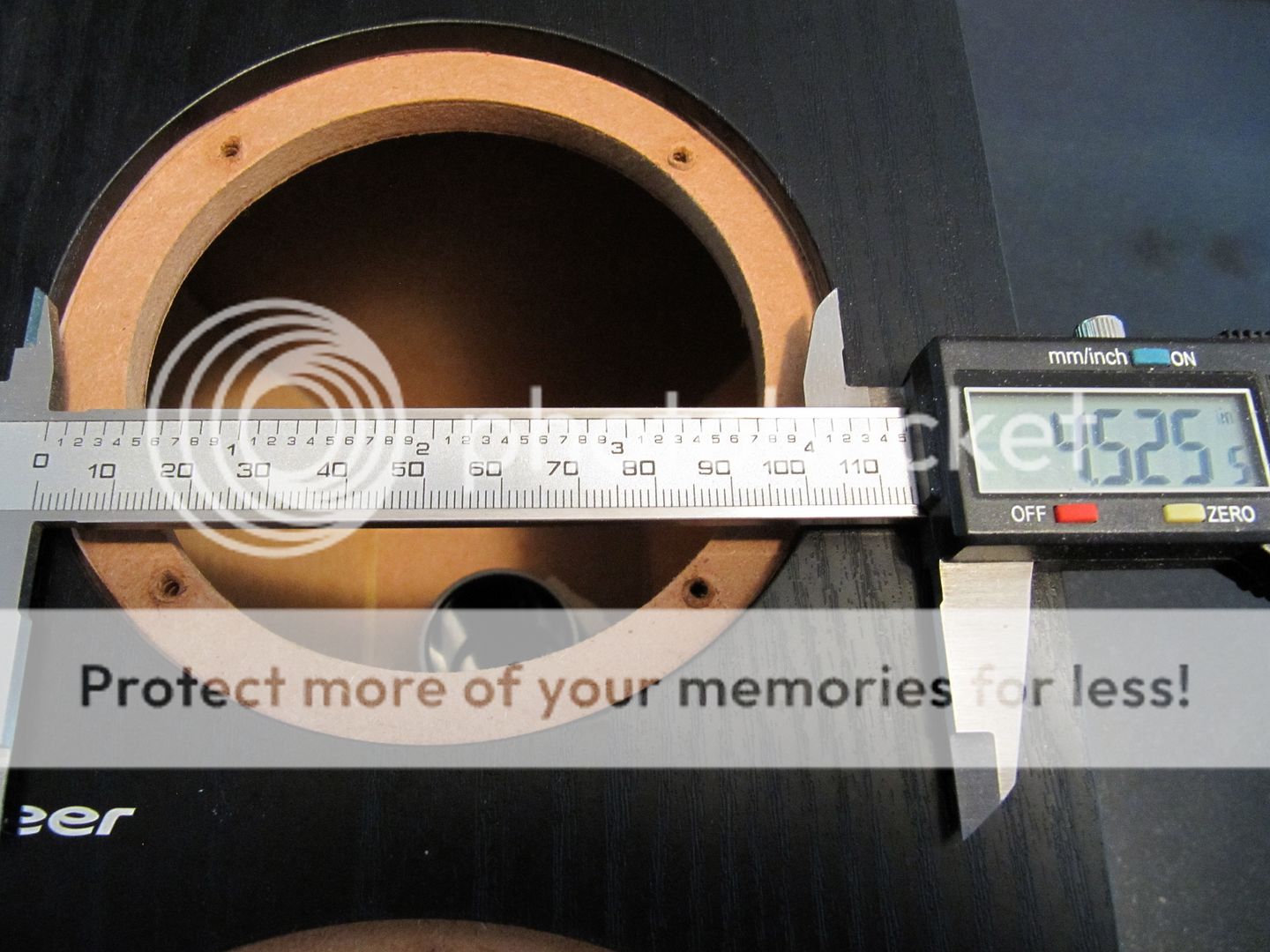

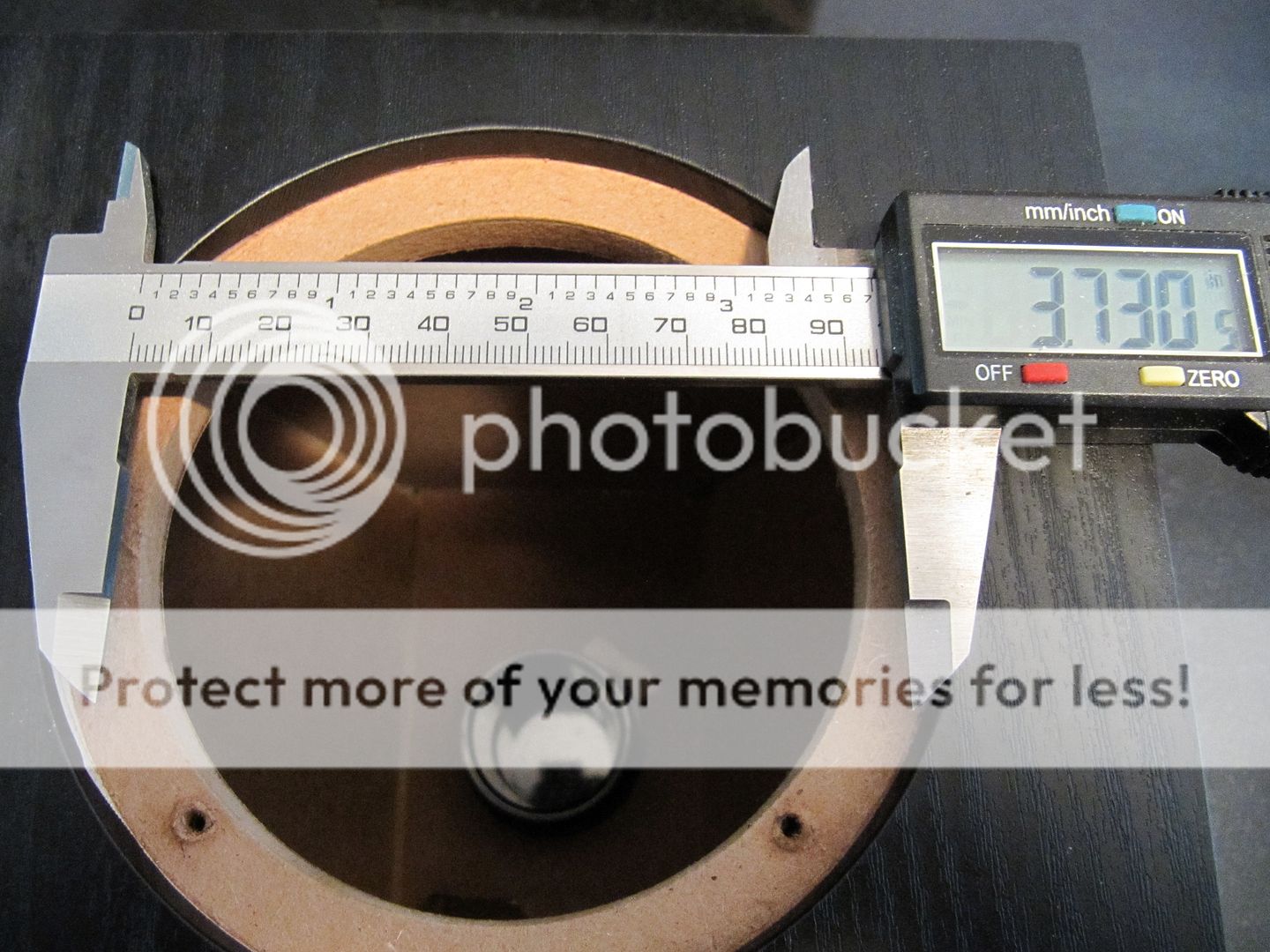

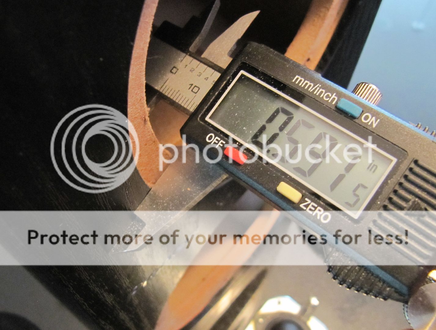

    Some physical measurements of the cutouts, etc. (in inches on the caliper readout)
    Woofer:
    Tweeter (recess):
    Tweeter (cutout):
    Baffle thickness – 0.59” which equates to 15mm MDF.
    BS21 in pieces:
  6. #6

    Whenever I measure speakers using RTA I get similar looking graphs to yours... it's interesting to see how your perceptions matched the measurements very closely.

    I have to learn how to use TrueRTA better.....I don't do smoothing, gating, splicing, etc. And yes, I also noticed that the charts pretty much confirm my listening impressions. I was really happy to see that BTW, as I don't think I have very stellar ears for critical judgement.
    Quote Originally Posted by fjhuerta View Post

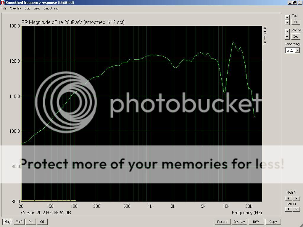

    I took the following measurements of my pair of SP-BS21's using ARTA several months ago. The on axis wasn't very pretty but that 10K dip and spike smooths out off axis.
    On axis:
    Off axis, 30 degrees:

    Two caps, two Inductors, and a internal brace. These are way overbuilt for "best buy" level audiphiles,
