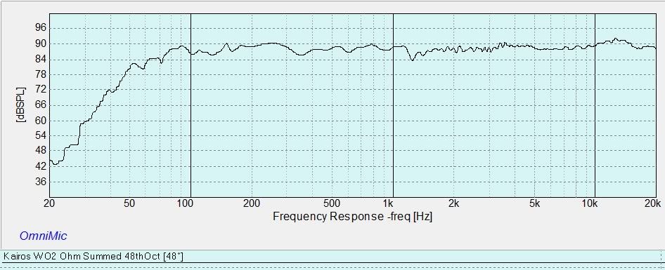

    Is the current ver 4 that comes with the new OmniMic the same as this file that I downloaded? I have been using this version 4 for quite a while now, but I was a but frustrated with the way the snap shots of the charts would always be so small (it actually changes size on the screen and then pops back to the former setting after it saves). I switched back to a version 3.x and, although some of the new features were missing I could get snap shot with the appearance that I wanted, like the one below. I went ahead and switched back to ver. 4, but I am stuck with the small snapshots again. Is there something I can do to get snapshots like I had in version 3?
    Thanks,
    Jeff
