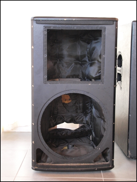

    Picture 1 - One of the empty shells. Those iddy-biddy holes at the bottom seem to tune the box somewhere between 42~45 Hz. No, the opening for the midrange/tweeter unit at the top isn't square.

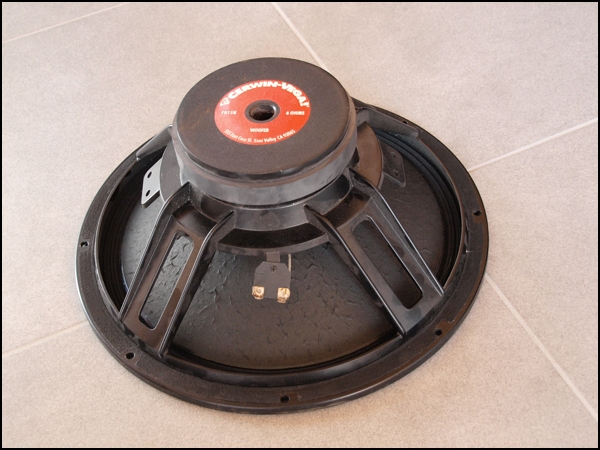

    Picture 2 - One of the 15" drivers, model number FR-15B

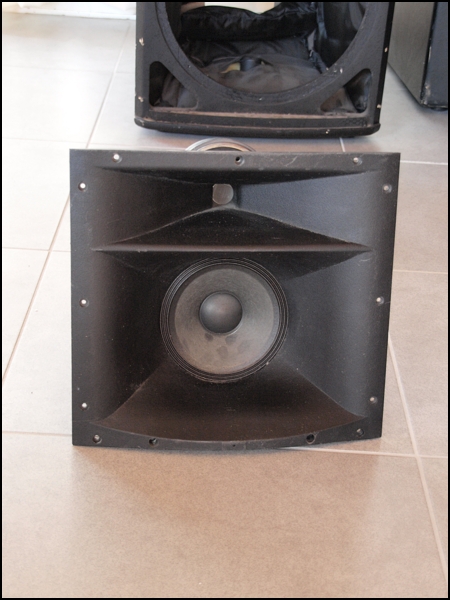

    Picture 3 - One of the midrange / tweeter units (front)
    Picture 4 - One of the midrange / tweeter units (rear)

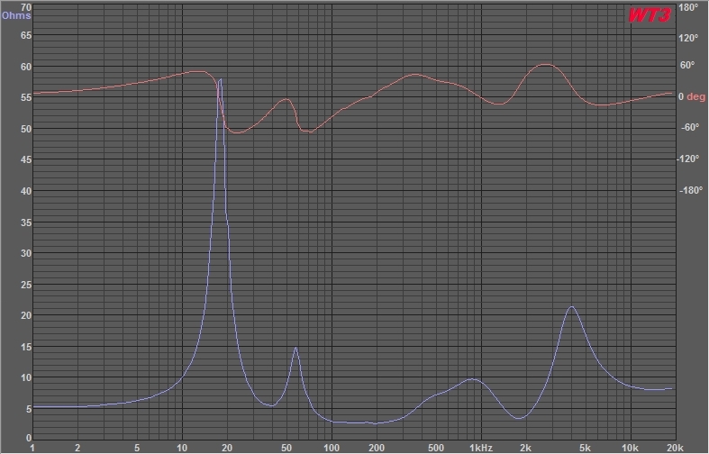

        I managed to fix one of the crossovers today. The impedance response of the speaker with the crossover in place is interesting to say the least. I'll cover it in another post.

          Above is the impedance response of one of the PSX-153 speakers with the crossover fixed (I borrowed parts from each crossover to get one working).
          I was a bit concerned about the dip to 3 ohms between 100 Hz and 300 Hz (the PSX-153 is rated at 8 Ohms) and thought I might have got the fix wrong, but the working one measures the same. Is this "normal" for pro audio speakers?
            No. It means it's a 4 ohm load or a defective crossover. Everything about those cabs just screams 'cheap'.
              Well, they're not the most expensive full range pro audio cabinets out there, but they don't look that cheaply built either. The main problem seems to be the crossover - seems strange for a 600W peak cabinet to find 10W in-line attenuation resistors in the midrange circuit. I believe CV did provide an upgraded version of the x-over, but the primary component of the upgrade seems to be two lamps in series with the midrange output from the x-over.
              Maybe I should just scrap the x-overs. and rebuild ones from scratch with better components...
                I would. While you're at it the tuning is really messed up. There should be nowhere near as much variation in the impedance peaks above and below Fb. Even a 2:1 ratio would be excessive, let alone 4:1.
                  While the speaker might be tuned for a bit of a bump in the bass area (they do sound pretty good with hard rock like AC/DC's "Back in Black"), Fb might actually be shifted upwards a bit - I noticed that the bludy pole mounts for the speakers are broken off, so there's another hole at the bottom acting as a vent too. Once I fix that, I'll remeasure to see if that makes much difference.
                    It just occurred to me that there might be another reason why the upper impedance peak is not as high as expected - the cabinet may be not be properly braced. There's a front to back brace, but not a side to side brace, and even when driven with just 25W, the sides were vibrating a bit too much for my liking. I'll repeat the impedance test tomorrow while bracing the sides to see if that has any impact.

                            Assuming that they use 8 ohm drivers that have a minimum DCR of 5 ohms the only way that 3 ohm region can be explained is by a flawed crossover design.
                              I just did a quick test - the impedance does change a bit when I add additional bracing to the box (I basically turned it on its side and sat on it, LOL), but the upper impedance peak actually went DOWN, which was a bit unexpected.
                              The bass driver appears to be a low Fs, low Qes, High Vas driver. Qe checks in around 0.30 and Fs at 31 Hz. Haven't measured Vas yet (I need to find a suitable container to act as a test box).
