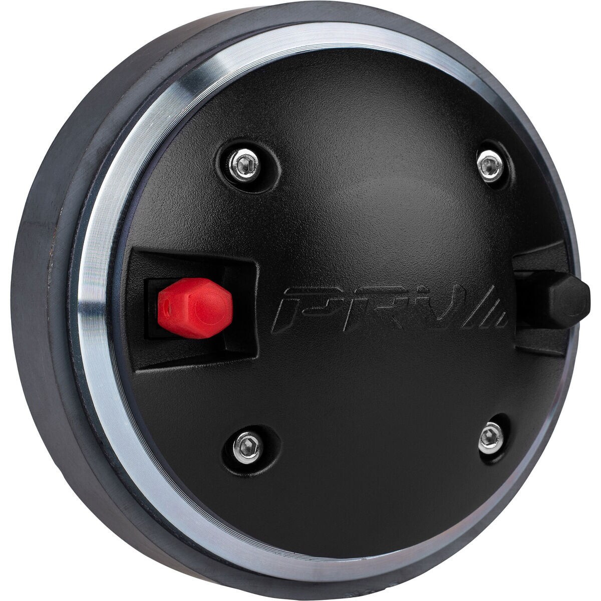

                            Ok, I officially hate all of you. Someone suggested 'econowave' speakers and now I have spent the last several days reading up on them. I learned my 2412 compression driver is not all that great and I would be better off with a polyimide driver. Any thoughts on the PRV D290py ($68/ea) or is best to save up for a B&C polyimide driver ($100-$130/ea)? I could not find many thoughts on PRV in general and just know they are some of the JBL Selenium engineers and execs from Brazil that started a new company.
                            PRV Audio D290Py-B 1" Polyimide Horn Compression Driver 8 Ohm 2/3-BoltPRV Audio's top-of-the-line D290Py-B polyimide 1" 2/3-bolt compression horn driver is designed to offer unsurpassed natural upper midrange and high frequency response, with accuracy not found in most manufacturer's stock PA speaker cabinets. The specially designed polyimide diaphragm sounds very similar to the silk and textile dome tweeters used in high-end home audio speakers and studio monitors. PRV Audio combines this diaphragm with a high-energy motor for high output over the usable driver bandwidth for effortless, dynamic output.High power handling is accomplished through the use of a Kapton® former and a 1-3/4" diameter voice coil, for a 90 watt RMS power rating when used with a 1,500 Hz 12 dB/octave high pass crossover, making the D290Py-B a drop-in upgrade replacement horn driver for nearly any speaker cabinet with an industry standard 2 or 3-bolt horn. Spring-loaded wire terminals facilitate quick connection. Includes screw-on adapter.Also available in a 1-3/8"-18 TPI model.Specifications: • Power handling: 110 watts RMS with recommended crossover of 1,600 Hz, 12 dB/octave slope • VCdia: 3" • Impedance: 8 ohms • Frequency response: 1,600-17,000 Hz • SPL: 109 dB 2.83V/1m • Dimensions: 4.72" diameter x 2.4" depth • Bolt thread and pattern: M6 x 2 (spaced at 3"), M6 x 3 (spaced at 2.4") • Net weight: 4.72 lbs. See the Related Items section for the replacement diaphragm.
