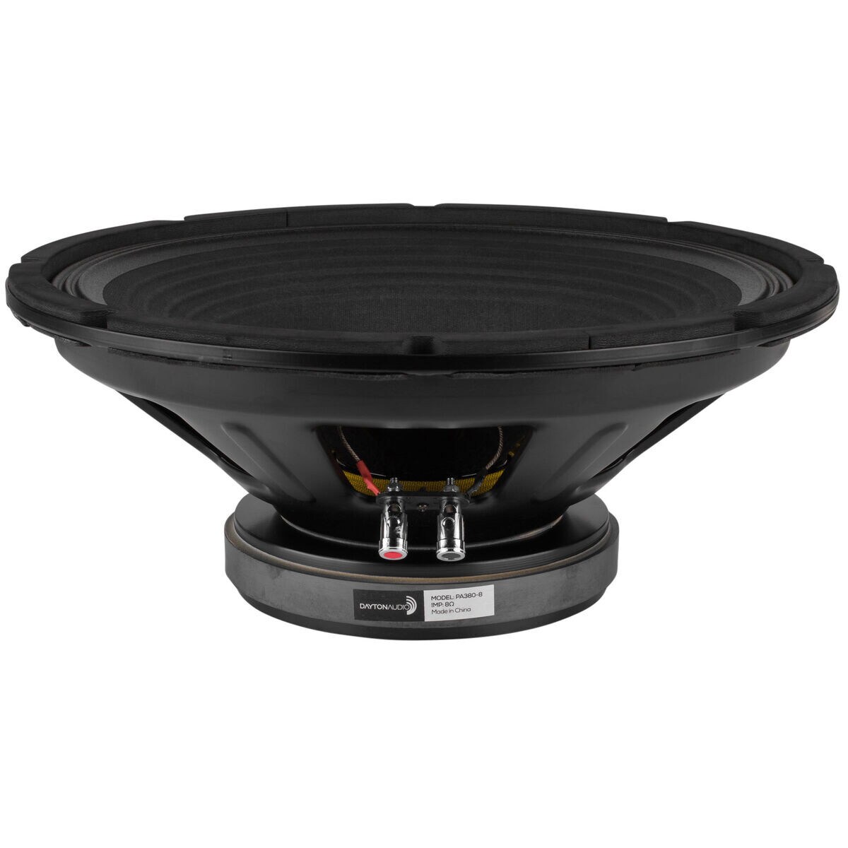

                            For the SS15 with the Dayton 15, which Dayton 15 are you talking about:
                            Dayton Audio PA380-8 15" Pro Woofer 8 OhmThe Dayton Audio PA380-8 15" PA Series Pro Woofer is a powerful upgrade for guitar, bass guitar or sound reinforcement cabinets. The PA380-8 also excels in custom-built speaker system cabinets. High power handling, smooth response, low distortion, deep punchy bass, and rugged reliability are the features that set PA Series woofers apart from other drivers – premium performance, but value priced.
                            Dayton Audio PA385S-8 15" Pro Subwoofer 4" VC 8 OhmWith over two decades of high-performance loudspeaker development experience behind them, Dayton Audio PA series subwoofers deliver powerful, dependable bass performance with all of the features and quality of pricey Italian-made pro subwoofers, but at a price that’s a whole lot easier on your budget.Klippel Optimized Motor Structure The Dayton Audio PA Series subwoofers feature optimized motor structures that provide over 11 mm of Klippel-verified Xmax (10 mm coil overhang) with excellent symmetry and linearity, preventing distortion where it often begins – in the motor itself. Cleaner bass means higher impact, and better musical detail. The enormous high-grade ceramic magnet is economical yet highly efficient and stable, providing parameters that are a drop-in replacement for most existing pro audio subwoofer enclosures, but a significant upgrade in performance to most OEM drivers. The motor structure also features a copper shorting ring and copper pole cap to reduce flux modulation and inductance distortion, for massively powerful and clean sound at all output levels.Advanced Cooling and Ventilation The key to reliable, high-output bass is to get the heat away from the voice coil windings. The PA Series subwoofers feature 4-inch voice coils that use inside-outside windings, improving heat transfer and reducing power compression. The coils are also wound on fiberglass formers, which are much more resistant to heat-related deformation. Finally, the high-strength motor structures employ extensive venting, below the spider, through the pole piece, and into the gap itself.Rugged, Reliable Construction The heavy-duty cones used on the PA Series subwoofers contain a blend of Kevlar and paper fibers, for strength, rigidity, and durability, and the ribbed cone structure provides the necessary stiffness to withstand punishing bass transients. The cone and voice coil assembly is supported by a rugged long-throw suspension featuring dual spiders and a treated and deep-corrugated triple-roll surround, for clean and low-distortion stroke. The cone is coated to withstand incidental exposure to liquid, and the dust cap is anchored by a heavy bead of epoxy for dependable cone integrity. It’s all held together by the finest adhesives and a tough cast-aluminum frame that’s ready to take some road abuse.When you’re looking for a dependable, heavy-duty subwoofer driver to power your system’s low end through anything, choose the PA Series pro subwoofers from Dayton Audio! The 15” model is optimized for maximum punch in compact vented enclosures or folded horn applications. 18” model also available.
                              https://www.parts-express.com/dayton...8-ohm--295-040
                              He likely meant the PA380 since it's truely cheap(inexpensive) and is similar to the Kappa in spec, but if you can afford the PA385 that is the one to use because when it comes to subs xmax is king.
