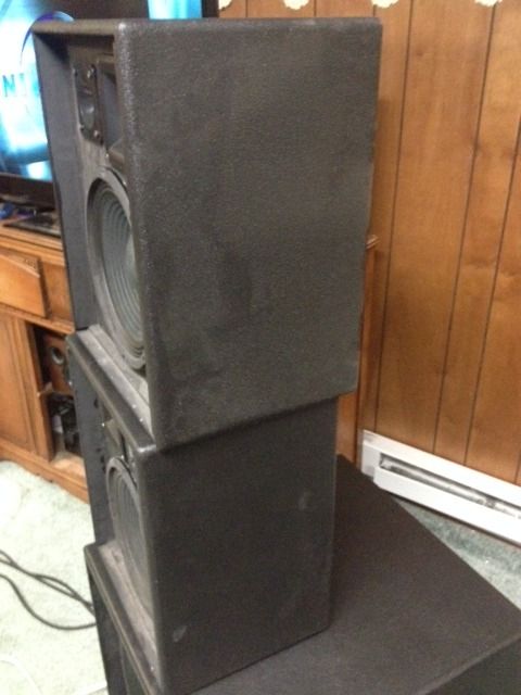

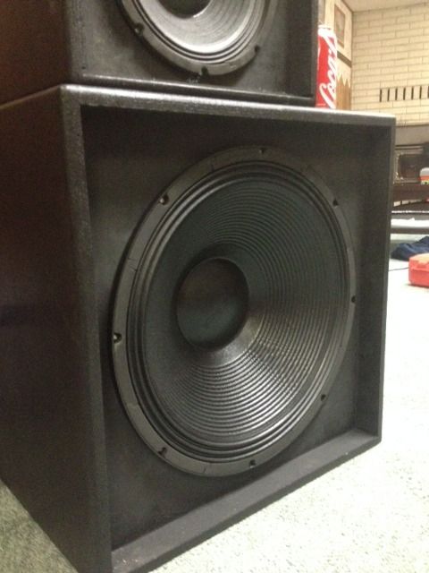

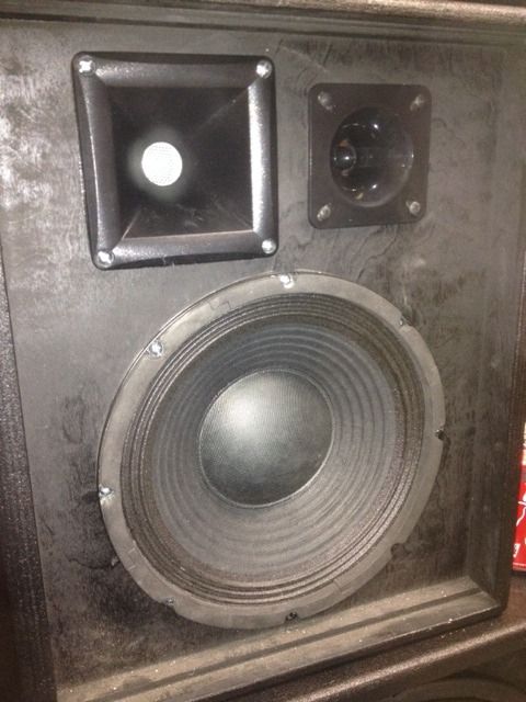

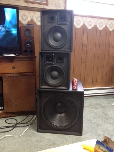

          It's been a long time coming, but here are the fruits of my efforts over the last few months. I ended up going with:
          (1) PRV 18SW2200 2+2 ohm 18" subwoofer
          (2) Dayton PA255-8 10" Pro woofers (xed ~1700 hz)
          (2) JBL Selenium D250-TRIO horn drivers (xed ~1700 hz)
          (2) Dayton 3 3/8" bullet tweeters (xed ~10khz)
          (1) Behringer iNuke 3000DSP
          Orignally, I didn't want to include the bullet tweeters, but at 10khz, the Seleniums dropped like a rock and sounded very dull. So I threw in the bullet tweeters as a list minute decision to cover the upper octave and add some sparkle. They ended up needing a lot of padding, but that's ok. I'm fairly impressed with the components that I selected: they all seem to be great bang-for-your-buck items. After some break-in and measuring, I ended up going with the suggested box volumes for both the PRV and the Dayton woofers; ~4.25 cu.ft tuned to 42 hz for the PRV and .9 cu.ft sealed for the Dayton. We'll see how long my B-i-L can go without blowing anything up :D

            Those look pretty decent. I guess you're running the two tops off of one channel and the sub off the other?
            The 3000DSP may not be enough to get the most out of the sub, but that might be a good thing :-).
            Do you have an impedance / frequency response measurements?
            Interesting choice of a sealed cab for the 10" tops. I might have gone for a slightly larger vented cab, then fix the low end with the 3000DSP's EQ, to get a bit more oomph out of it.
            Brian Steele
            www.diysubwoofers.org
            Comment
            • #21
              Re: Pro Audio vs home audio drivers?
              Thanks! Yes, yes, and not yet... I've got the two tops running off of one channel and the sub off of the other. The sub can definitely take more power - it'll probably handle the 3000DSP all by itself! I figured he can run all the speakers off of one amp for now, then add another one later if he finds the need and money to do so. That keeps things simple.
              Impedance and FR measurements will have to wait for a bit. I had to pillage my amp/mixer/mic setup to splice in the iNuke for testing and initial setup.... :( So those will wait. Though. lest anybody think I was shooting from the hip, I did used SE to design and measure the speakers before final assembly...
