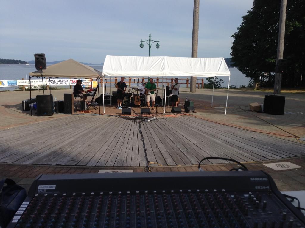

                          Thanks to all for the advice I got here. The event went really well.
                          That's two Yorkville LS2100. Yes there was a very audible power alley. But what am I supposed to do... All in all it worked out well. I don't think the subs were working very hard, but when the sub revealed the cones, they were travelling probably 10mm. Total WAG but it looked about that. I believe they're B&C woofers, so lots more in the tank, but was nice to know there was more available. Oh and the JBLs struggled a bit so I moved up my XO to 120hz and that helped. Sounded fine doing that.
                          https://www.youtube.com/channel/UCm2...oSKdB448TTVEnQ

                            Originally posted by ryanbouma View Post
                            ...That's two Yorkville LS2100. Yes there was a very audible power alley. But what am I supposed to do... ...
                            You could try to center cluster the bass bins dead ahead.
                            Adjustment with respect to L&R would have to be made.

                              Re: outdoor even - sizing equipment (particularly subwoofer)
                              To late. And as usual, center cluster just doesn't physically work for such an event. Would have hammered the band with bass, and looked awful.
                              The seating was very informal. Just sit down anywhere you please kind of thing. If the bass was to heavy, hopefully they moved. If not heavy enough, they probably missed out.
