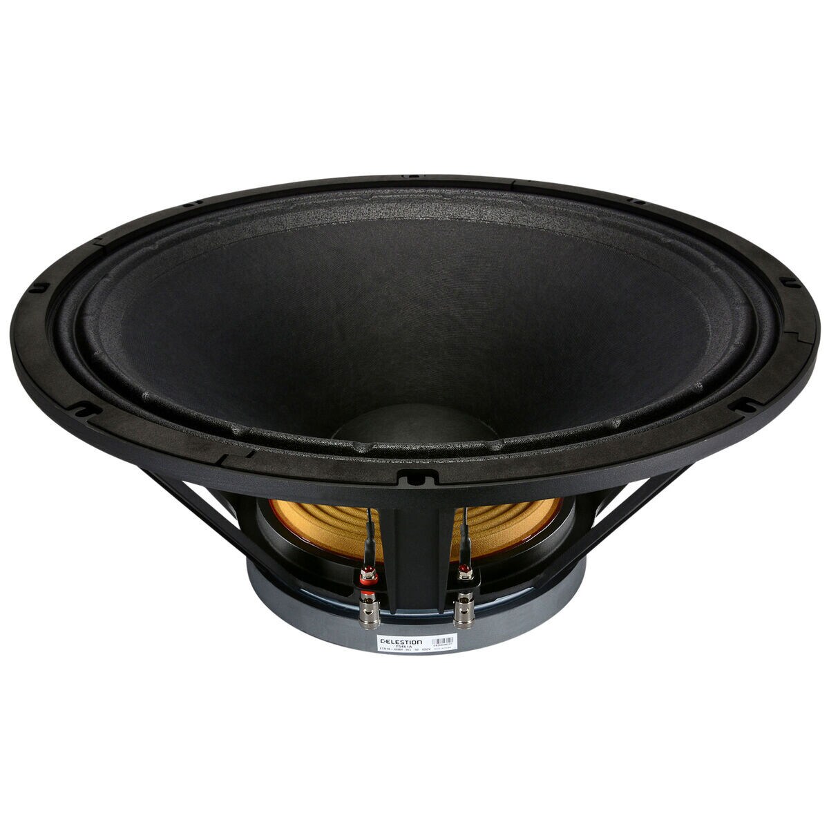

              Celestion FTR18-4080F 18" Professional Cast Frame Speaker 600WThe cast frame Celestion FTR18-4080F 18" pro woofer employs the same great technology and construction as its sibling speakers, but at a lower price point. The FTR18-4080F's 110 oz. ceramic ferrite magnet, Inside/Outside 4" voice coil, and advanced thermal management work in combination to make this one of the best bang-for-the-buck professional drivers, period.

                I must have missed the T24, Looks like they will work. Thanks Bill.
                Thanks for your input Sydney but, I think an 18" will be too big.
                  PE has already done a BassBox simulation on that driver ( woofer Selection Guide ) and it came up with a 3 cu ft model.
