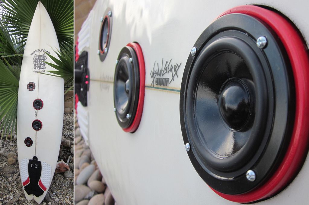

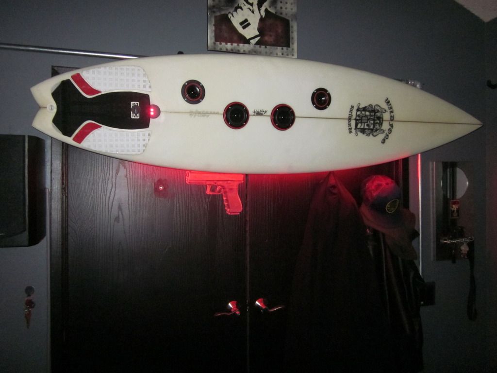

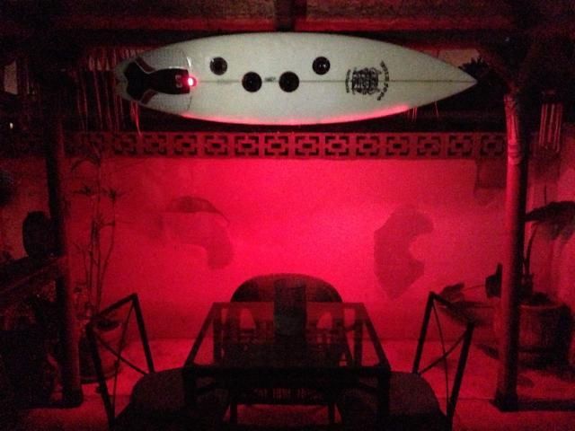

    A co-worker asked me to put speakers in an old surfboard for him to hang up in his back yard palapa.

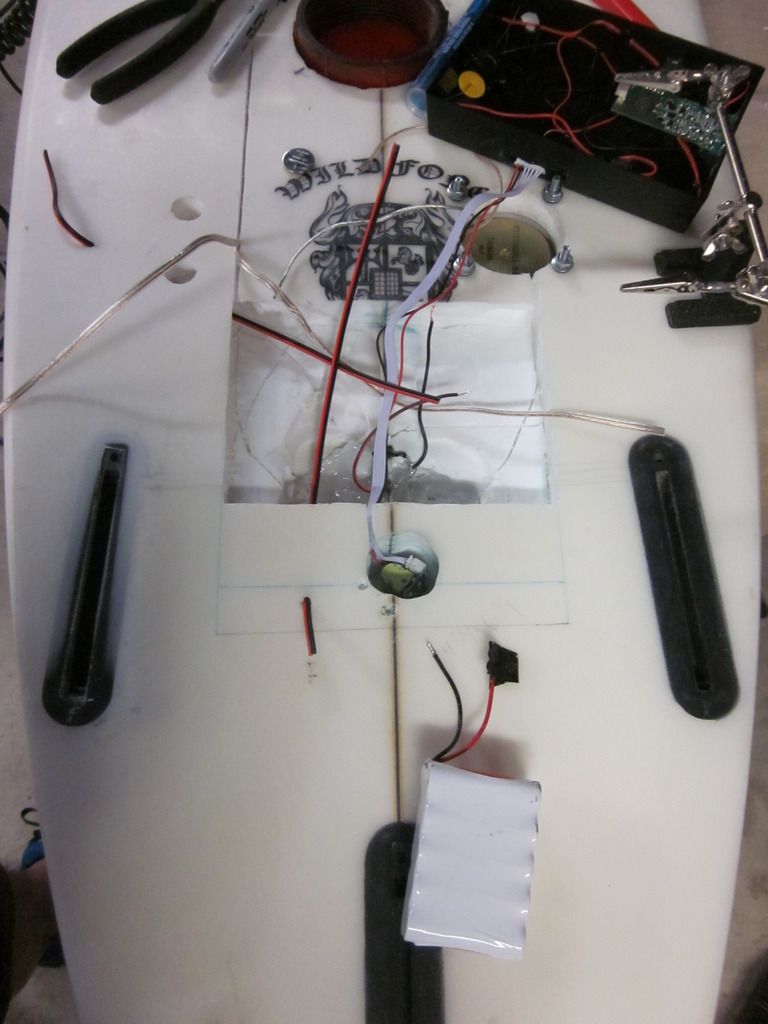

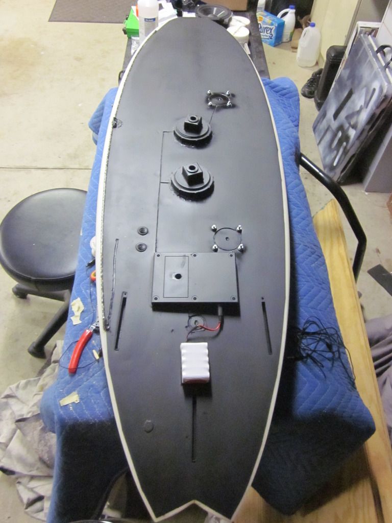

    I used the 3" Dayton DS90-8, buyout paper cone tweeters (overkill), Dayton DTA-2 amplifier, 4800 mAh 12v battery, an LED all weather light strip, and some plumbing for the enclosures. Puts out decent sound. The tweets were turned way down with resistors. All sealed up in a project box. Lots of dremmel work.
